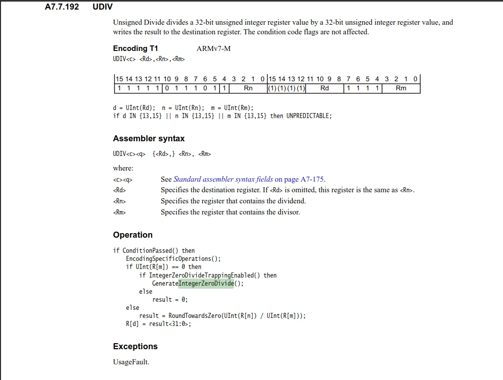

Here, I’m intentionally dividing a uint8_t value by zero inside the APP_Test_Init function, causing a Hard Fault.
When I examine the *.map file, shouldn’t I be able to see the APP_Test_Init function?

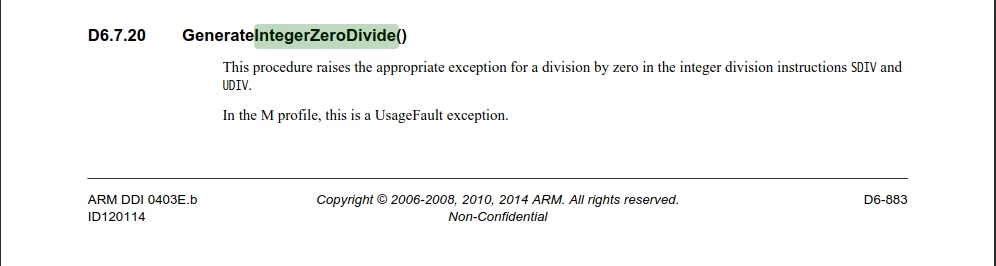

Dividing by zero should "normally" generate an usage fault on the ARMv7-M architecture, not a hard fault.
You can read this in the ARMv7-M TRM:UDIVUDIVUsageFault raised by UDIVUsageFault raised by UDIV
Because when I try to divide by zero in C:
int test(unsigned char a)
 return a / 0;
GCC use UDIV for the calculation in the resulting object file:
test.o: file format elf32-littlearm
Disassembly of section .text:
00000000 <test>:
 0: b480 push {r7}
 2: b083 sub sp, #12
 4: af00 add r7, sp, #0
 6: 4603 mov r3, r0
 8: 71fb strb r3, [r7, #7]
 a: 79fb ldrb r3, [r7, #7]
 c: 2200 movs r2, #0
 e: fbb3 f3f2 udiv r3, r3, r2
 12: b2db uxtb r3, r3
 14: 4618 mov r0, r3
 16: 370c adds r7, #12
 18: 46bd mov sp, r7
 1a: bc80 pop {r7}
 1c: 4770 bx lr
