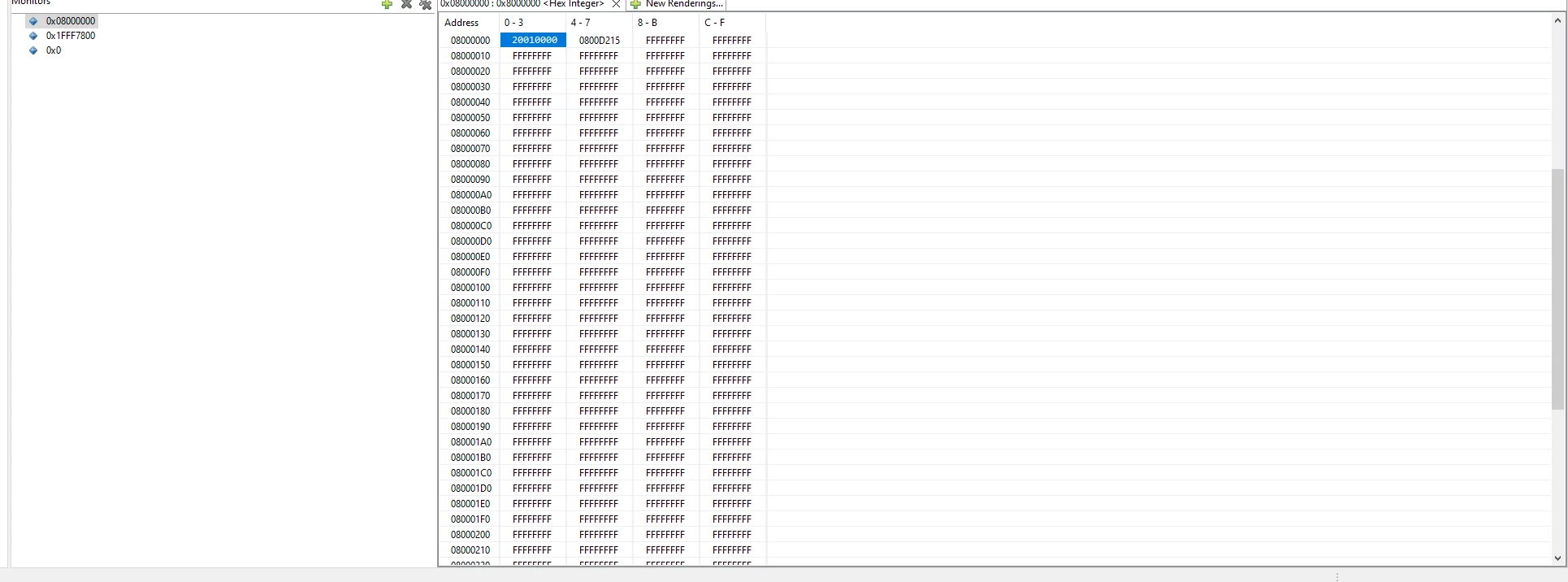

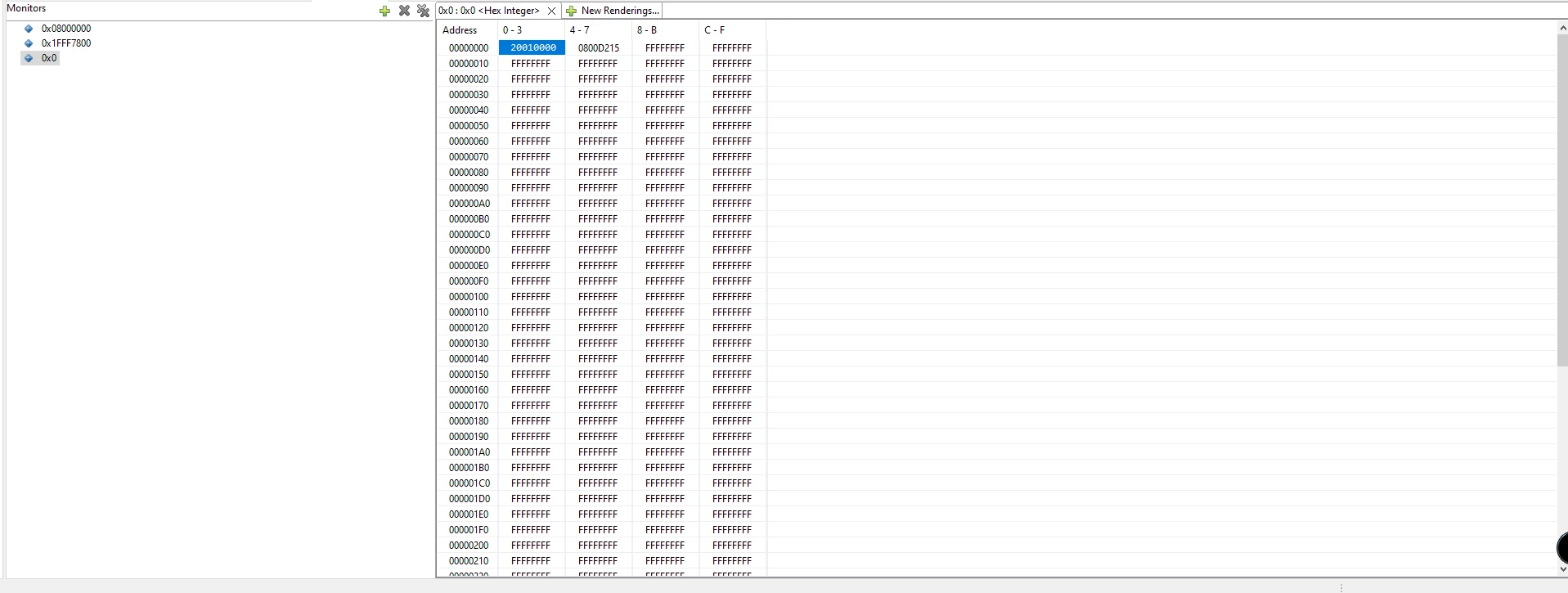

Memory view at 0x00000000 might also be illustrative.
alexxs
alexxsAuthor
Jun 28, 2022 8:51 AM UTC
The memory, both when it works (please see message below) is identical between the start address of the flash memory and what it's mapped at 0x00000000 0693W00000Nsu4tQAB.png0693W00000NsuTOQAZ.png

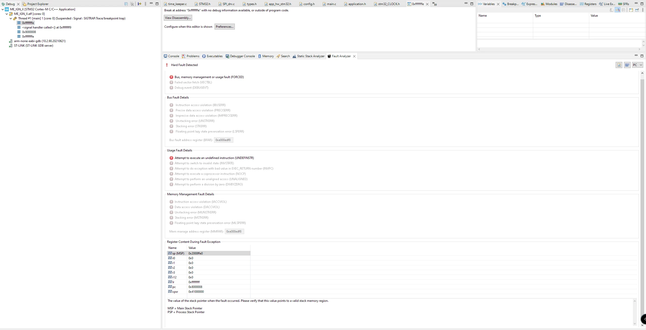

So this is how the call stack looks along with the Fault Analyzer after the initial debugger run. 0693W00000NsuLZQAZ.png
However, if I press the "Reset the chip and restart debug session", it correctly goes to the 'main' routine. The problem there is that it doesn't seem to be able to load the source files and I can't debug. This is odd because:
  1. The simple app can be debugged from the first start of the debugger (I don't need to reset the chip and restart the debug session in order for it to work)
  2. Is able to correctly open its source files

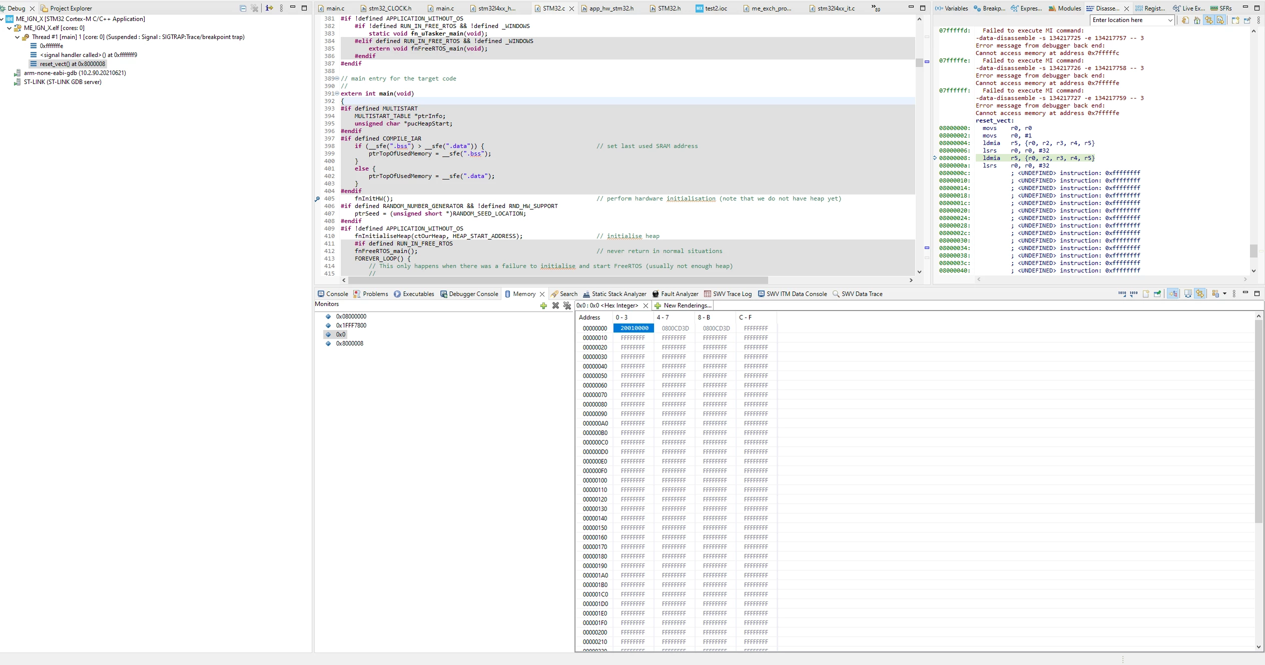

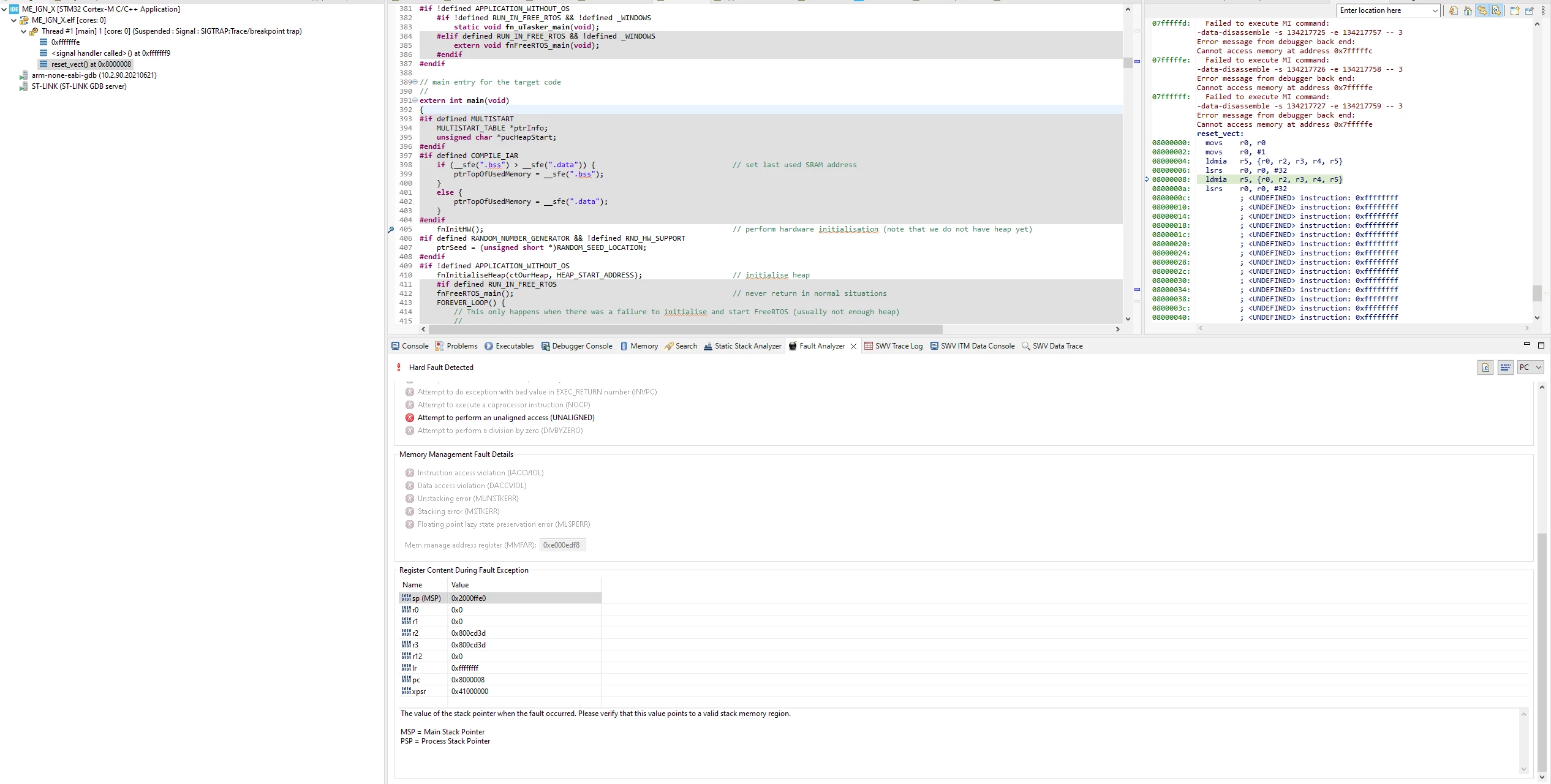

Jun 28, 2022 6:22 PM UTC
> It's very unusual that the interrupt vector table is completely 0xFFs. Are you sure this is intended?
The interrupt vector table is not all 0xFFs. It's a valid solution to only have the first two words of the boot area programmed, one with the address where to put the stack and the other with the address of the reset handler. My problem is that, no matter what breakpoints I put in the reset handler, it never hits it without resetting the debugger once.
Then, as the MCU is initialized, VTOR is pointed towards the beginning of RAM, where the running vector table is stored.
I've attached two screenshots. One shows the Fault Analyzer, the disassembly and the source code, while the other one shows the memory from where it boots. I've also tried putting a handler on NMI, but it still triggers the fault.
