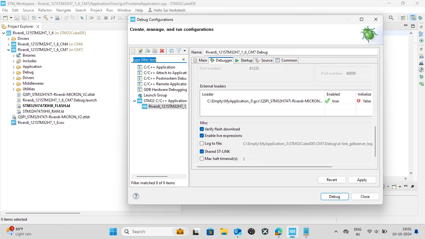

I have created a demo project using touch gfx I'm able to flash that project using touch gfx. But when I try to flash that project using Stm32Cube ide it raises an error like "Failed to execute M1 command". Please refer attachments for more details.

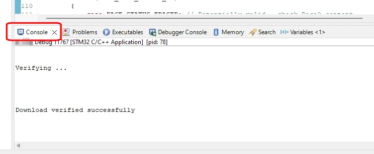

October 10, 2024
Thank you for your valuable responses. I resolved the issue by making some changes in the debugger configuration. Specifically, I added the QSPI loader file in the external loader option located at "PROJECT_LOC\..\gcc\QSPI_STM32H747I-Riverdi-MICRON_V2.stldr" After debugging it again, everything works well now. Please refer the below attachment. Screenshot (94).png

Hello @sai1 ,
In the folder STM32CubeIDE/CM3/Debug, do you find the .elf file?
Under "Run" => "Debug configuration" => "YourBoardName_Appli", what is the C/C++ application specified?
Can you clean and rebuild.

I generated code using the TouchGFX tool, but when I tried to open it in STM32CubeIDE, I encountered several issues. Does this capture what you wanted to convey? If you need further adjustments, feel free to let me know!The display board I’m using is the RVT121HVSNWC00-B, and the controller is the STM32H757.
sai1AuthorBest answer
October 10, 2024
