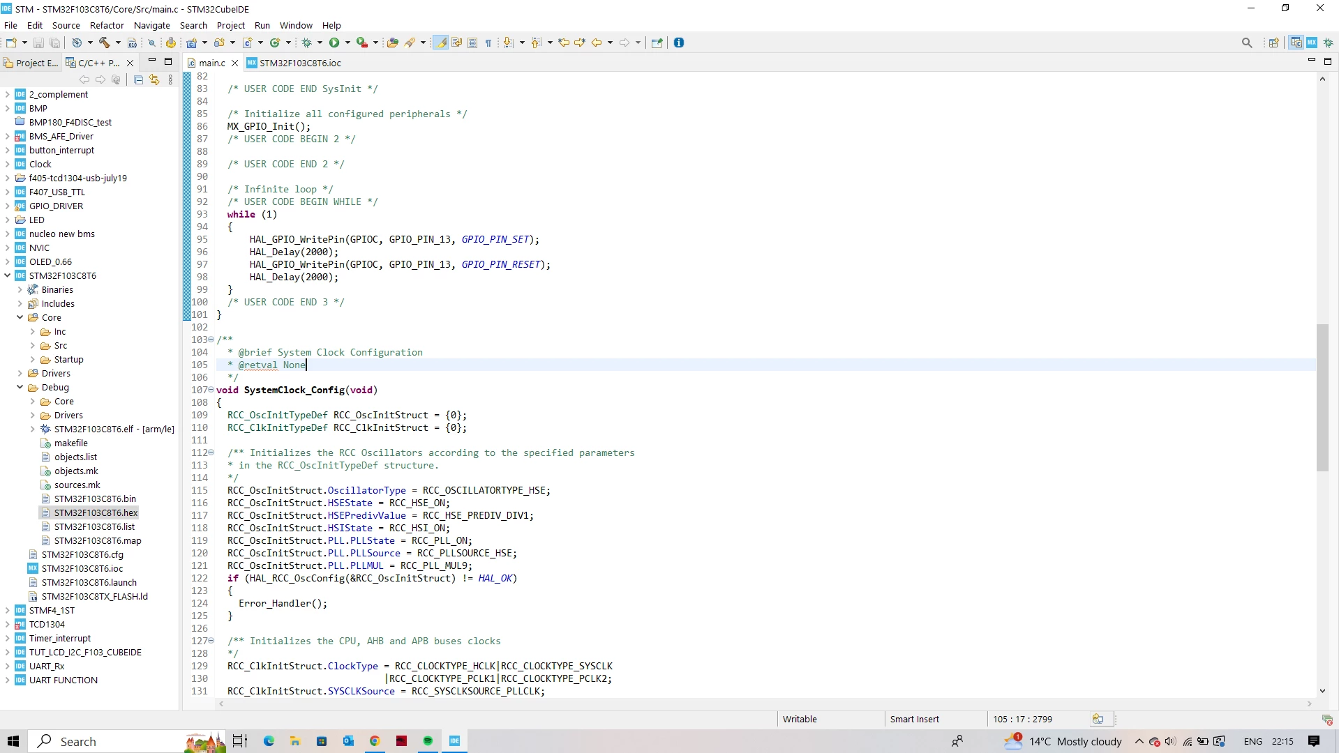

STM32 Cube IDE Cosole not shown
Hii everyone,
I am new in STM Cube IDE. After install the Cube IDE it's not show any console where I can check the the status of the code like the error or suggation or status of any action. I attach my Cube IDE's snapshot for reference.
Please help me to solve this problem. I tried different method like uninstall and install or go to STMCube IDE Window-> Show view-> Console / Build Analyzer, but nothing works. Please guide for the solution. Looking forward for positive reply.

Hello @Subhrajit Majumder
Try to reset the views by going to Window->Perspective->Reset Perspective. Then, Window-> Show view-> Console. This should be enough to resolve the issue.
