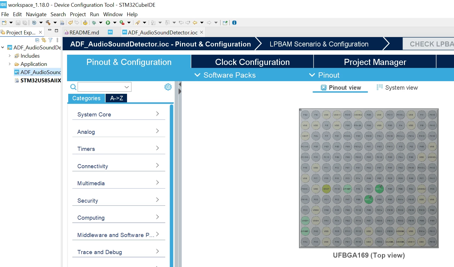

Im trying to run the ADF_AudioSoundDetector example from one of the example list of B-U585I-IOT02A board i generated code from cubeMX of this example. i did not change the ioc files when i try to open the project from stm32cubeide to run it, nothing comes up. So i deleted the whole project from the workspace and tried to create a new project of this example but the error keeps showing up that the project exist in the workspace even though i deleted the entire folder from the workspace. i even deleted the latest .meta log files.

Hello @jzzunn
Please download the latest package of STM32CubeU5 from the st.com or GitHub. Then, open the .project under Projects/B-U585I-IOT02A/Examples/MDF/ADF_AudioSoundDetector/STM32CubeIDE with your STM32CubeIDE. We recommend installing the latest version of STM32CubeIDE v1.18.0.
Note: I use both versions of STM32CubeIDE, v1.14.1 and the latest v1.18.0, and they work well.
