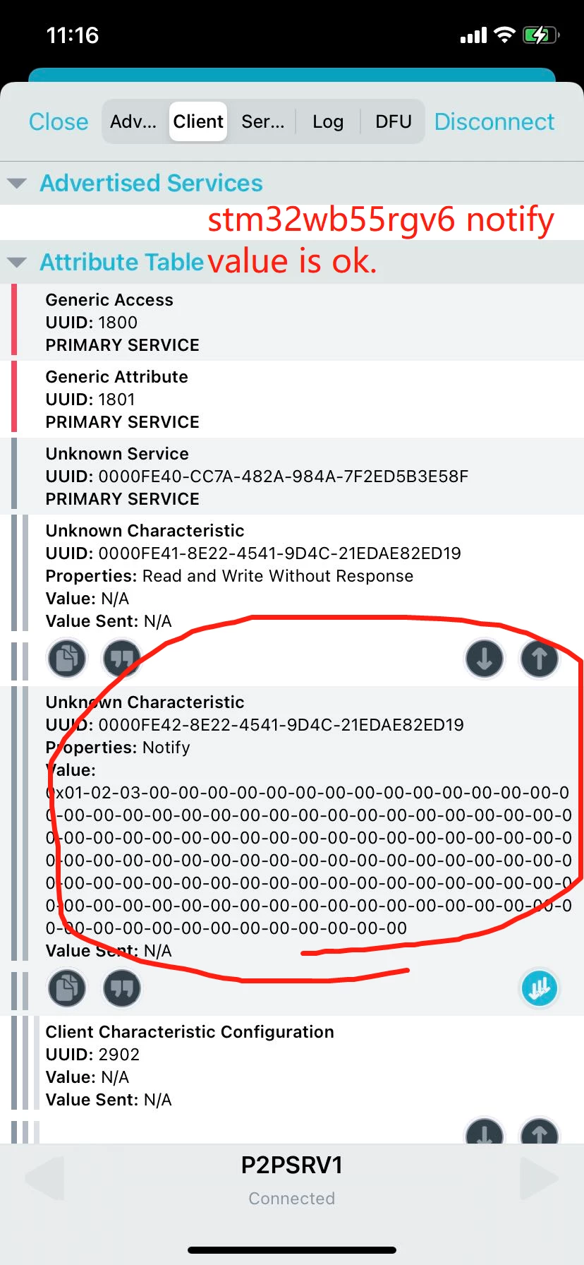

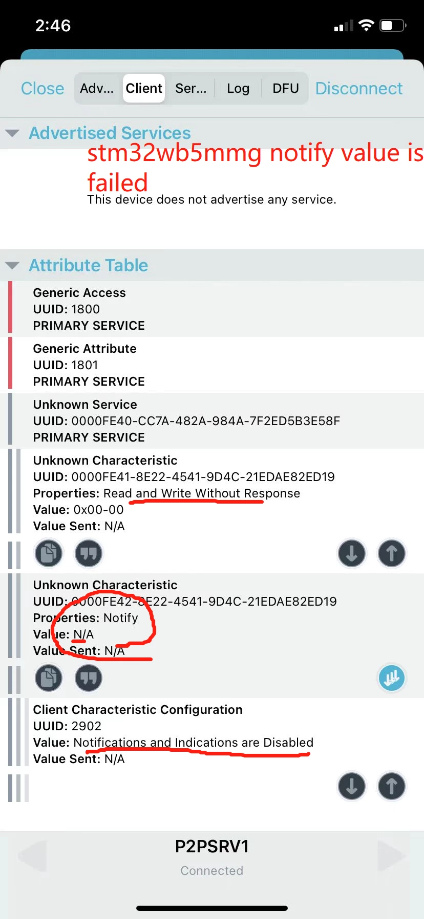

I used stm32wb55rgv6 and stm32wb5mmg in the stm32wb series for simple Bluetooth projects (using hw_timeserver to send notification data), and then used nRF Connect to receive notification data.
My program and design are basically the same, but only stm32wb55rgv6 succeeded, while stm32wb5mmg failed, as shown in the figure:
I have compared these two projects many times, and based on an5289, I think his process is quite normal. I guess there is something wrong with the design of HW_timeserver timing triggering. For the specific design, see the program in p2p_server_app.c below:

Thank you for your reply. I still haven't solved this problem. You can understand my problem as: implementing a simple Bluetooth notification function (BLE-p2pserver) based on stm32wb5mmg. I can connect normally and find the notify characteristic, but I can't update the notify value.

This problem has been solved. The reason for this problem is that some interrupts are not enabled.
