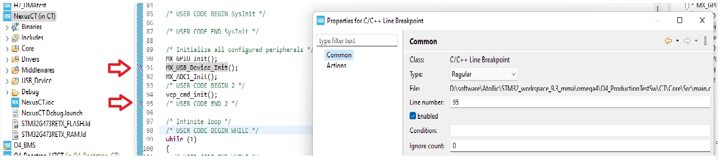

Somehow my STM32CubeIde does not allow to put breakpoint at any project see attached picture.
  1. I've read that this issue can be caused by too many projects on workspecae - I reduced the number of worspace procect but still does not work
  2. I thinks that I have set something that it disable breakpoint for all existing projects
  3. I tought that was IDE issue - I have upgraded the IDE from 1.8.0 to 1.9.0 - It does not help
Any Idea how can I return the breakpoint functionality.

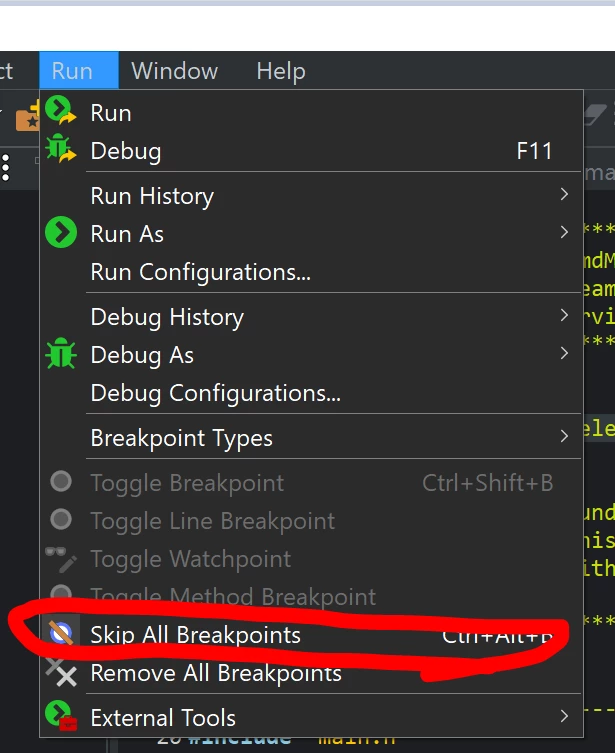

TDKBest answer
March 11, 2022
Ensure "Skip All Breakpoints" is unchecked.
Go to Show View -> Other -> Breakpoints to view all breakpoints currently set.

Thanks a lot,
Skip All Breakpoints was de issue
