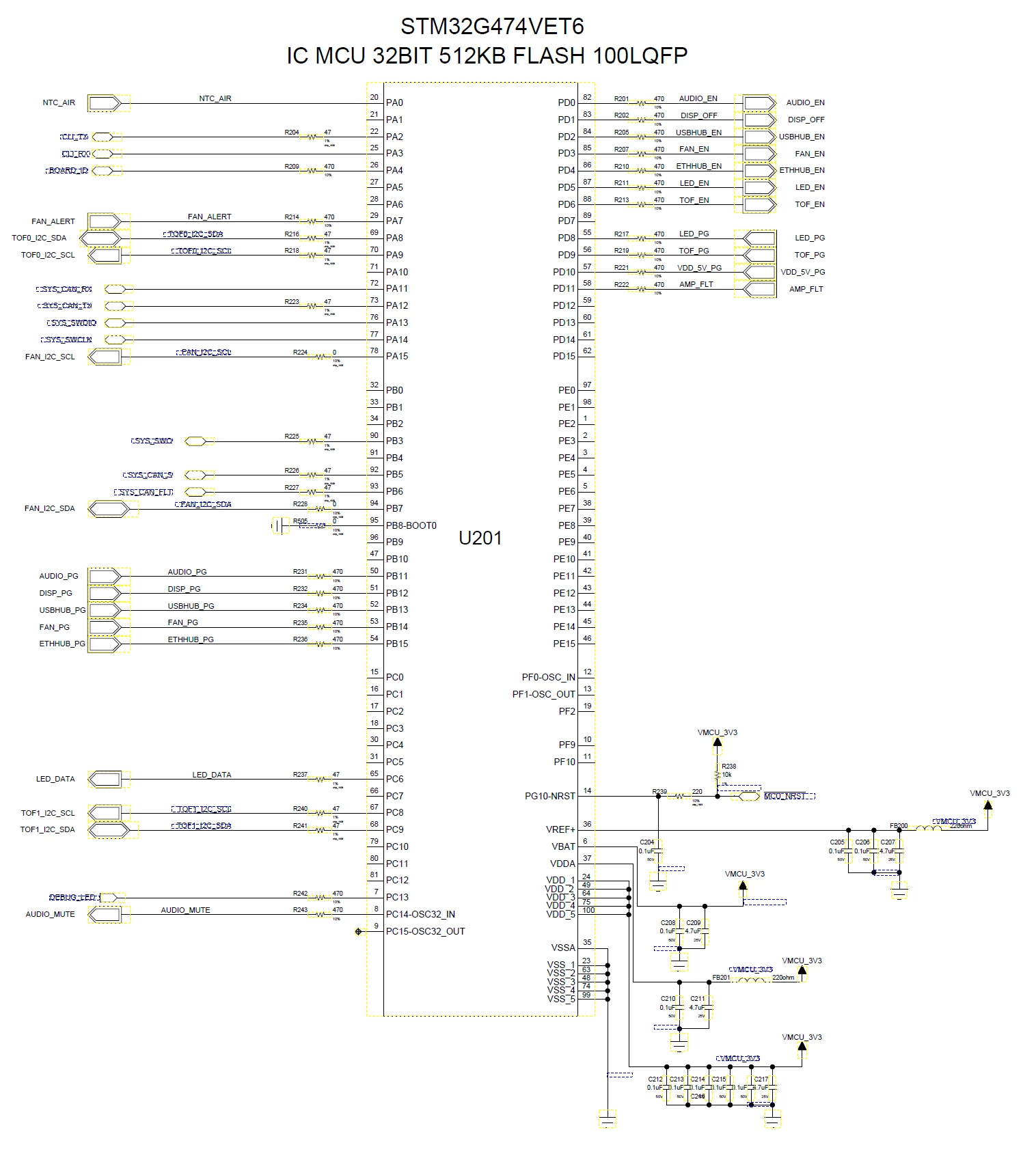

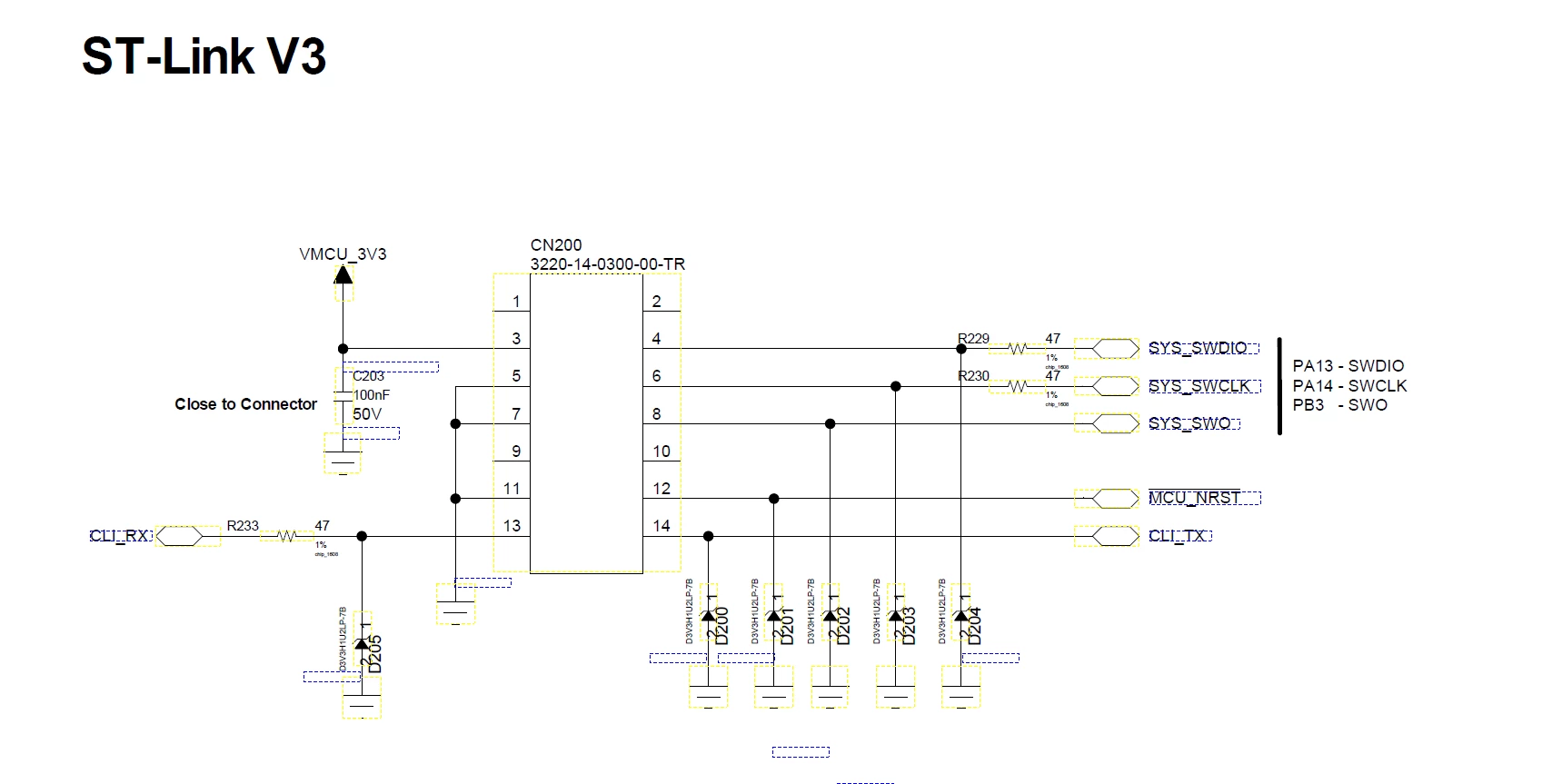

I am experiencing a consistent connection issue with my development setup:
Hardware/Software Configuration:
  • MCU: STM32 (exact model: STM32G474VET6)
  • Debugger: STLINK-V3
  • IDE: STM32CubeIDE
  • Programmer: STM32CubeProgrammer
  • Operating System: Window
  • Target board : Custom board
    • art of custom board schematics :

Questions:
  • Has anyone experienced similar issues where STM32CubeIDE fails but CubeProgrammer succeeds with STLINK-V3?
  • Are there recent changes in CubeIDE or driver packages that could explain this?
  • Any additional steps or patches recommended for resolving this mismatch?
  • Are there any configuration that i can try on CubeIDE? (eg data rate)

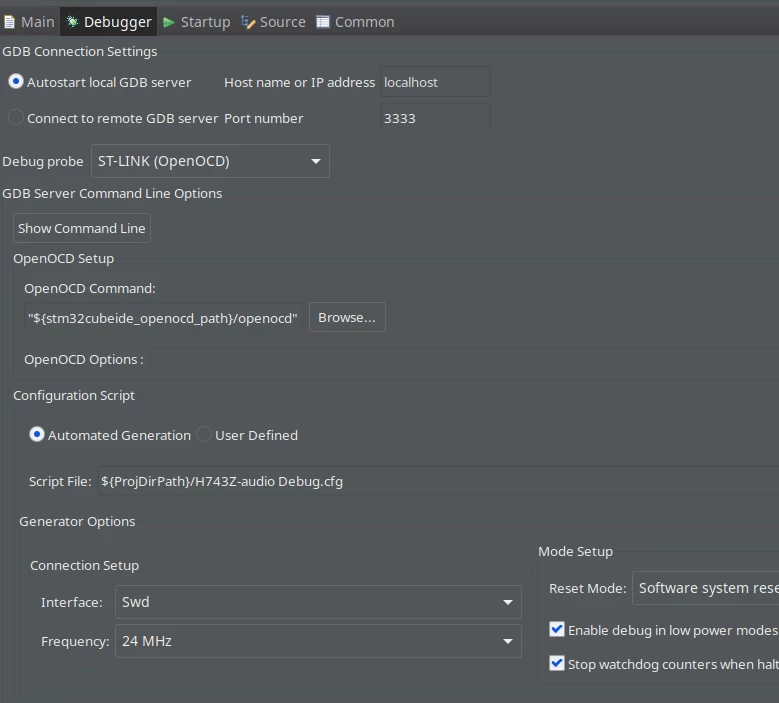

Sep 15, 2025 11:41 AM UTC
>  While many boards face connection issues with STLINK-V3 in STM32CubeIDE, some boards succeed to be connected.
The IDE checking the cpu is "genuine STM" , so it refuses connect on all cpus that might be not from STM.
CubeProgrammer connects -if possible- also to other ARM cpus.
But here , on (i assume) genuine STM32G474VET6 , it should connect also in IDE .
Maybe try: set debug to using openOCD  (i had some strange "no target.." , but switching the debug to OCD - it works.  And even switching back the debug setting, it works. This happened also on boards, working before....and then also working again. So dont ask me "why" .)
so try: (and adjust the settings...see:)
