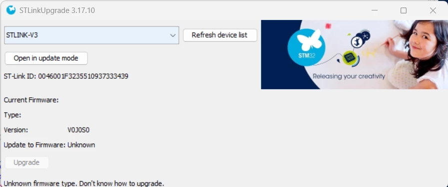

STlink Firmware Update
Hello
My Nucleo-H755ZI-Q board disconnected mid-STLINK firmware update, and I am now unable to complete the process.
Could you please guide me on the next steps to resolve this?

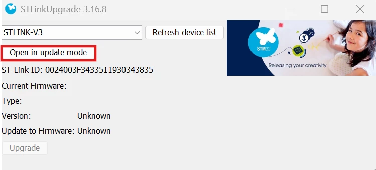

Hello ​@HC1994
Let me thank you for posting and welcome to the ST Community.
I recommend that you click on Open in update mode then click on Upgrade.
Thanks.
Mahmoud
