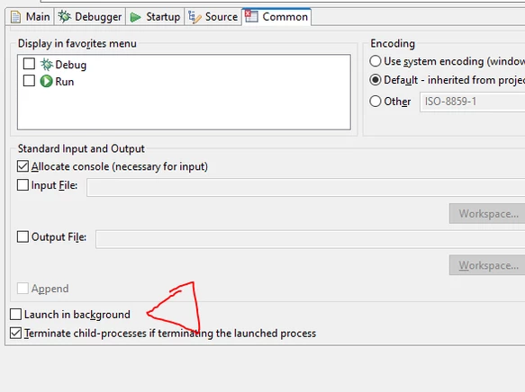

Disable this option.
[Debug Configurations > Common]
With that option disabled, 'Progress' window is in foreground during debug session launch process.

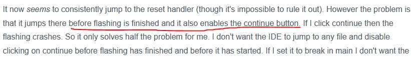

This is related to Cube's behaviour where the 'Run/Resume' button becomes enabled even though the flashing of the board has not finished.
