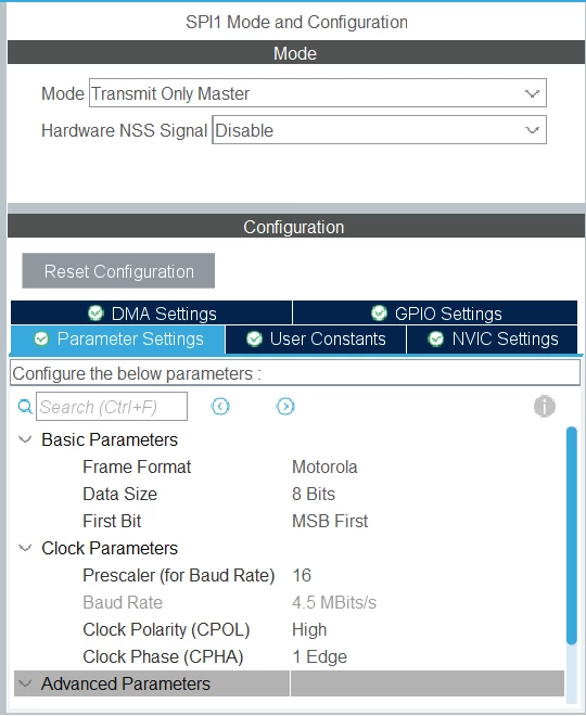

I can't get a simple ST7789 screen working I have tried using this library:- https://github.com/Floyd-Fish/ST7789-STM32 double checked all the connections (including external 8MHZ crystal) and all seems to be fine, I have tried various different settings with the SPI and DMA none of which work. Just wondered if anyone here has had a working program? I am using a simple Nucleo STM32F303K8 MCU. All I get is blank screen.

    I had a similar problem (unsolved) with this driver on a display 2.0TFTSPI GMT020-02 VER:1.1 240x360px  (you see blank screen and I see only garbage).
    There are some things to look:
    1. The Driver.
    1.1. This driver needs to configure the GPIOs that you use for CS, DC and RST pins.
    1.2. This driver needs to configure the resolution, orientation, displacement...
    1.3. I had a warning in compilation about varible types.
    It was about 1 year ago. Perhaps the driver version is actually different
    2. The hardware: In some sites people says that the display need to be mounted on a PCB, without wires
    And however, the SPI configuration
    I expect I helped you. I tested with two blue pills and three displays, and never worked. I didn't found the correct combination

    LinkpadAuthor
    Hi Xisco,
    Thanks buddy I found these small SPI screens are fussy about how you connect the SPI wires and power wires and best like too use PCB tracks where possible, I changed my jumper connections and the ST7789 sprang to life!
