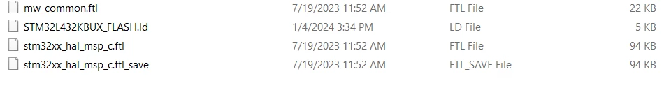

Visitor II
January 8, 2024
Thx,
Now I have the MCU package downloaded, I configured the WWDG in the .ioc file and selected 'Generate Code'
The main.c does not get updated and there are 'wwdg' related files in the STM32L4xx_HAL_Driver folder.
There are some misc file in the main folder that look odd.
I'll try to create a new project and configure a WWDG.
Pavel A.
January 8, 2024
It drops .ftl files in the main folder?? Very strange. Something is broken.
Visitor II
January 8, 2024
I have the files under source control (Perforce/Helix, yes old school). Once I checked out stm32l4xx_hal_conf.h the 'Generate Code' seems to generate the appropriate updates.
Should have better error checking/notification to not get into this state.
