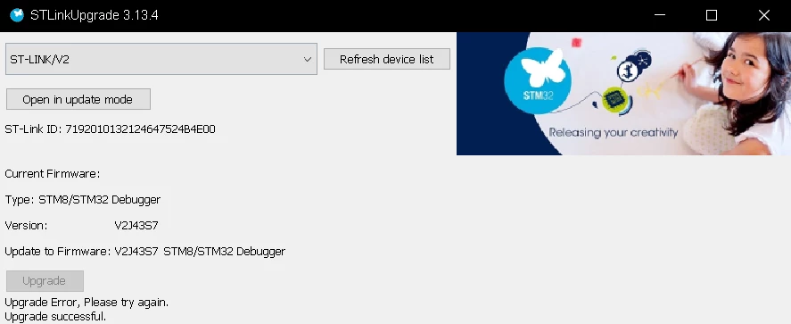

ST-Link V2 Update Error
I can't update my ST-Link V2
When i try to update first it says update error after that update succesfully.

    February 7, 2024
    What OS? You're already at the current version.
    In Win7 there can be quite a significantly lag between "Open in update mode" and the drivers being installed properly for the different device it presents.
    Potentially other issue is apps, like Keil etc, have a currently open context with the ST-LINK.
    Serial# doesn't look obviously fake
    AnilKoseAuthorBest answer
    February 8, 2024
    I fix it thanks for reply.
    I fix with hex folder.
