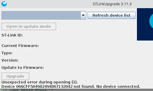

I run CubeIDE on Linux and when I want to Debug, it prompts for an ST-link upgrade. I click Yes and I get screenshot no. 1. The ST-LINK ID displayed there is correct, I get the same ID with "st-info --probe".
Then I click on Open in update mode, and I get the error in screenshot no. 2. Any ideas would be greatly appreciated.

I guess it's ok now, but pretty strange.
I plugged the USB cable directly into the computer instead of the hub, but no luck. Tried another cable, still nothing.
My PC is dual  boot, so I booted into Windows and installed CubeIDE and the package. When running the debug configuration, it asked for the update just like in screenshot 1. Unlike in Linux, the firmware was updated successfully in Windows. After this I rebooted into Linux and was able to run the debug configuration without any issues.
I then tried in Linux my 32F746G Discovery board. Same issue like screenshot 2 for this device ID. I rebooted into Windows and did the same thing for the Disco board. It asked to update the firmware and it updated successfully. Then I rebooted in Linux and was able to run successfully the debug configuration for this device ID.

It has updated the firmware ))  So now CubeIDE on Linux sees the new version and does not want to update it anymore.

I just tried again on Linux. I opened CubeIDE, Help -> ST-LINK Upgrade. I clicked on 'Open in update mode' and same error. I restarted CubeIDE and followed the same steps again and this time it worked. Same thing with the other board.
At least now it works on Linux. Sometimes. I might not have to use Windows next time, if I try several times until it works.

To understand this, think what means the "update mode". The updater tells the ST-Link firmware to simulate disconnect (likely, do software reset) and then expose a different USB interface to the host - which the updater expects to detect after a short delay. Something fails in this procedure. Windows is one, but Linuxes are many. Everyone can build their own kernel, USB drivers... because of this, Linuxes are so hard to support. As someone said - "Linux is free, but not cheap".

When I run "lsusb" the board is listed there.
When I run "st-info --probe" to see the details of the board, it returns this
st-info --probe
Found 1 stlink programmers
 version: V2J41S27
 serial: 0670FF505356867767065641
 flash: 1048576 (pagesize: 2048)
 sram: 327680
 chipid: 0x449
 dev-type: STM32F74x_F75x
Ok, everything looks good, but this stage is exactly when I get the error in CubeIDE when running the ST-link updater.
What I do is unplug the board, plug it back in and I DO NOT run "st-info --probe". If I don't run that command, the updater is perfectly fine, time after time. If I do run the command and it returns all that fine information, the updater will simply not work.
I'm very curious why "st-info --probe" causes that behavior, but it's probably one of those rabbit holes in Linux where you spend a lot of time with very little return.
