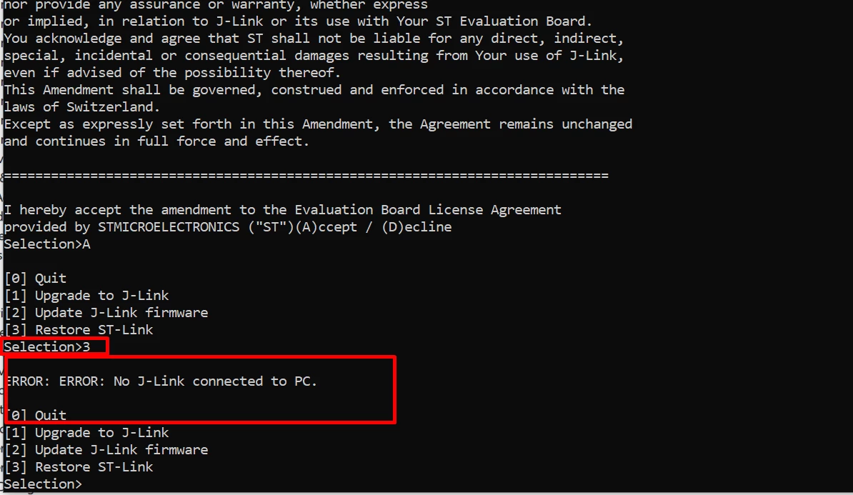

I have converted ST Link into J link by performing instructions here.

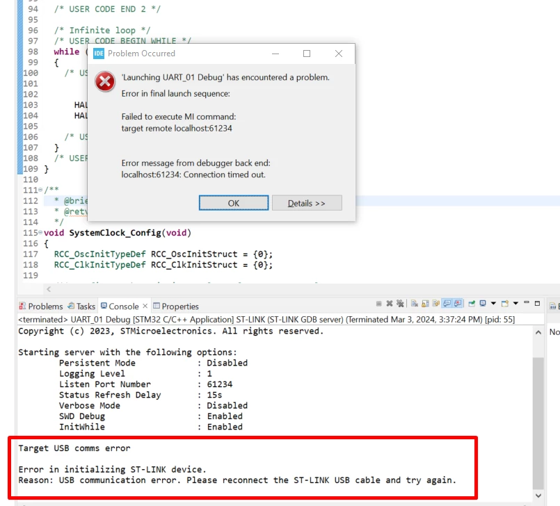

Afterwards, I converted J-Link into ST Link. But, I can not use ST Link driver. I can not connect to the board via ST Link. I get this error below. Could anyone help me with this please ?

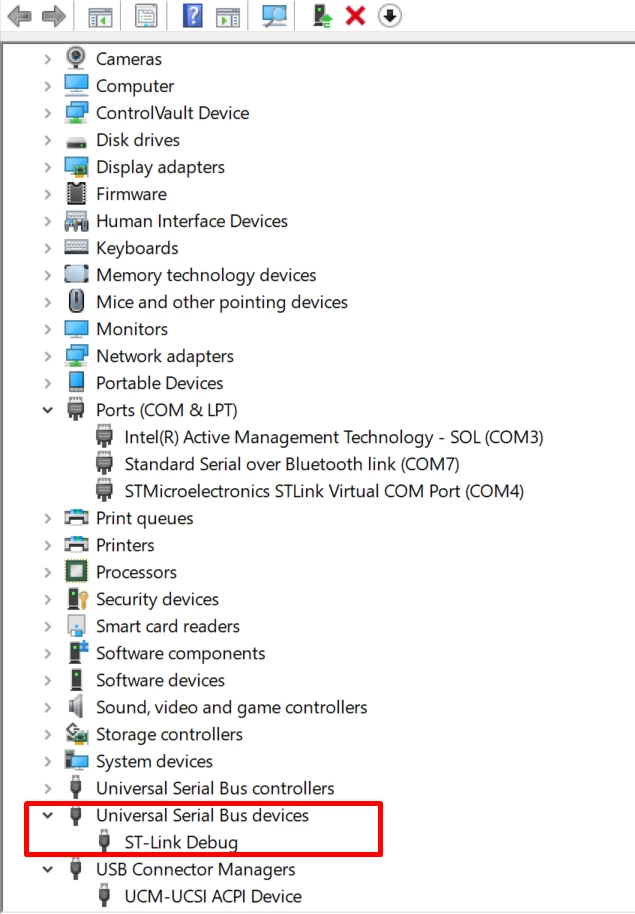

I have connected the board directly to the USB port on PC, not via hub or deck.
I have checked that, ST-Link Debug is seen under device manager.

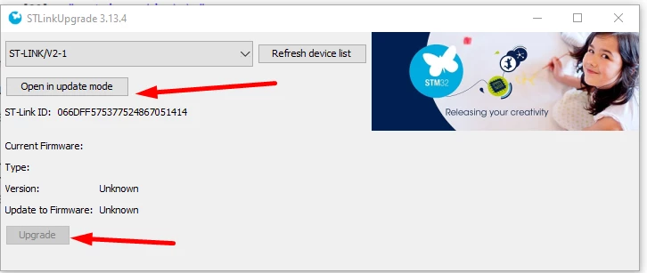

    Unplug the usb cable from the PC, then plug it and immediately click on Help --> St Link upgrade -- > Open in Update Mode --> Upgrade.

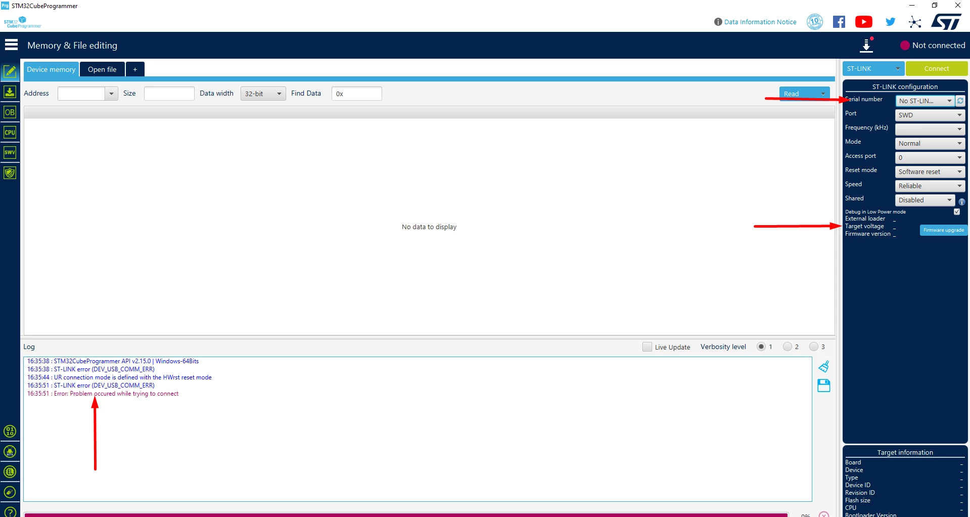

    Can you connect with STM32CubeProgrammer? Does the STLink show up? Does the target voltage show up?
    demirAuthor
    Senior
    March 3, 2024
    I can not.

    Yes, I rebooted but that didnt return things to normal. I have double checked unflashing of J-Link is successful or not, please see below image from STLinkReflash tool.
