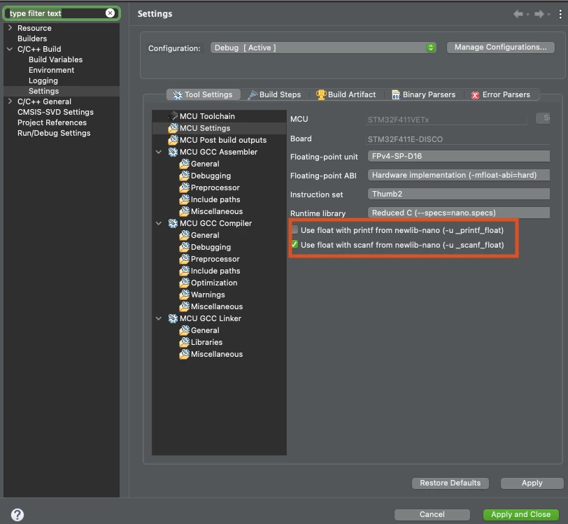

In order to use 'float' type with 'scanf' and 'printf' functions in CubeIde, you need to enable it in project settings.
0693W00000QLKLeQAP.pngHopefully this solves your issue. And this will parse float 'string' to a float variable.

thank you #PMish.1 for the solution:)
