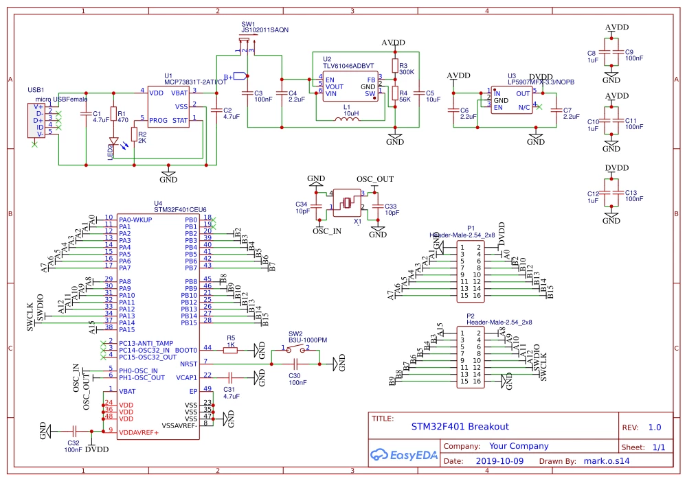

I designed a breakout board for the STM32F401CEU6. (Schematic attached)
I am using it to receive data from an ADC chip over SPI.
The ADC chip has a data ready output which should be used as an interrupt pin to let the MCU know there is data available to be read.
I have used the ADC chip with the Nucleo-F401RE, and it works perfectly.
Now using it with my breakout board, it works fine when in blocking mode, but not when using the interrupt. I am using the same code (aside from changing some bits relating to the CEU6 package as opposed to the RE package.
The SPI operation starts from the GPIO ISR.

spiRxBytes_IT is just a wrapper of the SPI Hal API
HAL_StatusTypeDef hal_stat = HAL_SPI_Receive_IT(&hspi1, pdata, length);
I am supposed to receive 27 bytes of data, thus the callback function below should be called after 27 bytes have been received.
void HAL_SPI_RxCpltCallback(SPI_HandleTypeDef *hspi)
 rx_done = 1;
However, the callback function is never called. When I debug the function below, I find that the counter RxXferCount never counts down. Thus, the branch SPI_CloseRxTx_ISR(hspi) is never reached.

Can anyone provide a suggestion on why this is happening?
1 reply
Visitor II
Hi! Were you able to solve the issue?
I am facing something kinda similar except my RxXferCount decreases and it eventually reaches zero but the receive completed callback never gets called for some reason.
