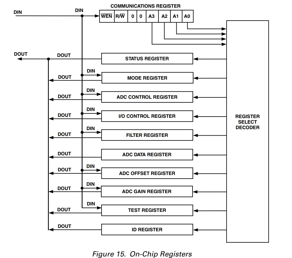

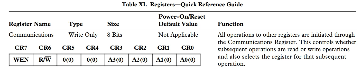

Hello everyone im currently working on a adc AD7708. I want to read chip from the device but i cant get any valid value. Here is the register sturucture of AD7708:
I wrote a basic code to read the chip id from id register. Here is the code:

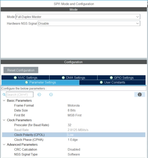

I examined it with the scope and i think there is no problem in MOSI line. But i cant see any signal in MISO line.  Here is my spi settings in stm32cubeide.
I couldn't find the problem. What should i do?

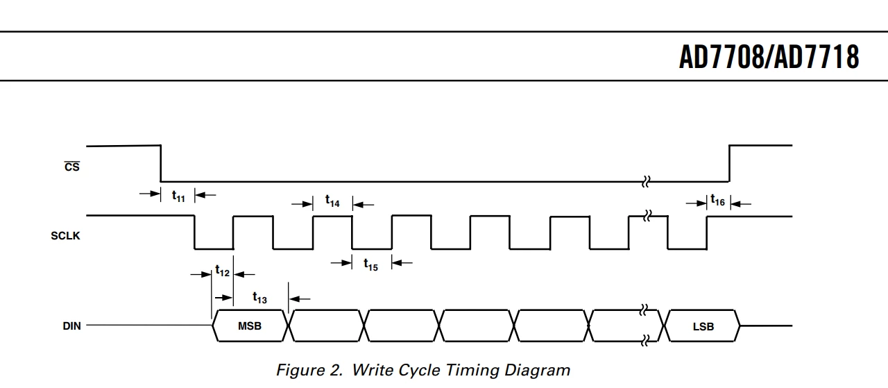

So at first set the SPI signals , as this adc needs :
in Cube set : cpol hi + cpha 2 edge .
+ use HAL_SPI_TransmitReceive( ..) ;
+ how to set the command -- i hope you read the manual...
