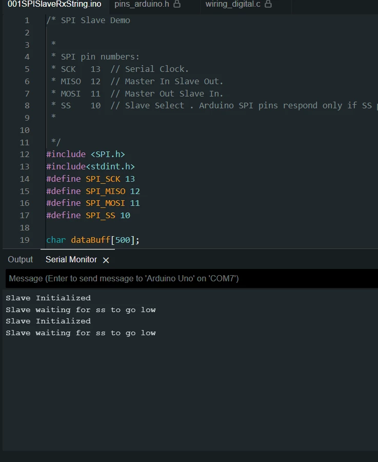

SPI Not communicating with aurdino
So , I wrote all driver my self so dont know how to ask this but i can provide you with few code.
This is main.c file and other driver file is attached below........

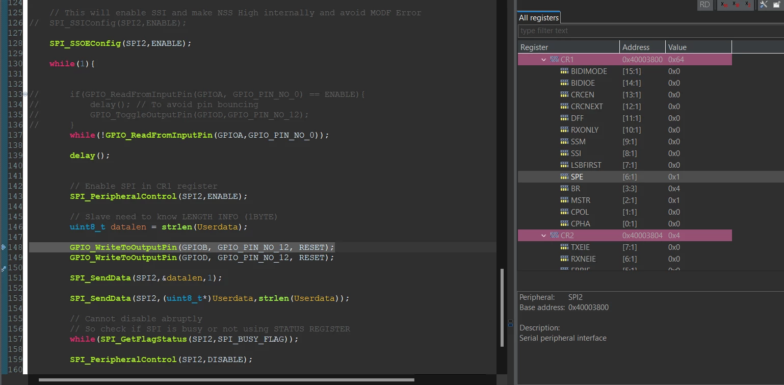

    > So while debuggging First while loop so it works fine , it loops back as expected then i checked for register values and they do seem fine
    Respectfully, this is still more non-information. If everything looks fine, then what is the problem? Are the signals coming out of the SPI correct? If not, how are they incorrect? I don't want to dig through 10 pictures in order to try to guess and find what the problem.
    If you're very stuck, I would recommend getting some HAL SPI examples to run and comparing your register values between that working code and your own, in order to narrow down on the problem.

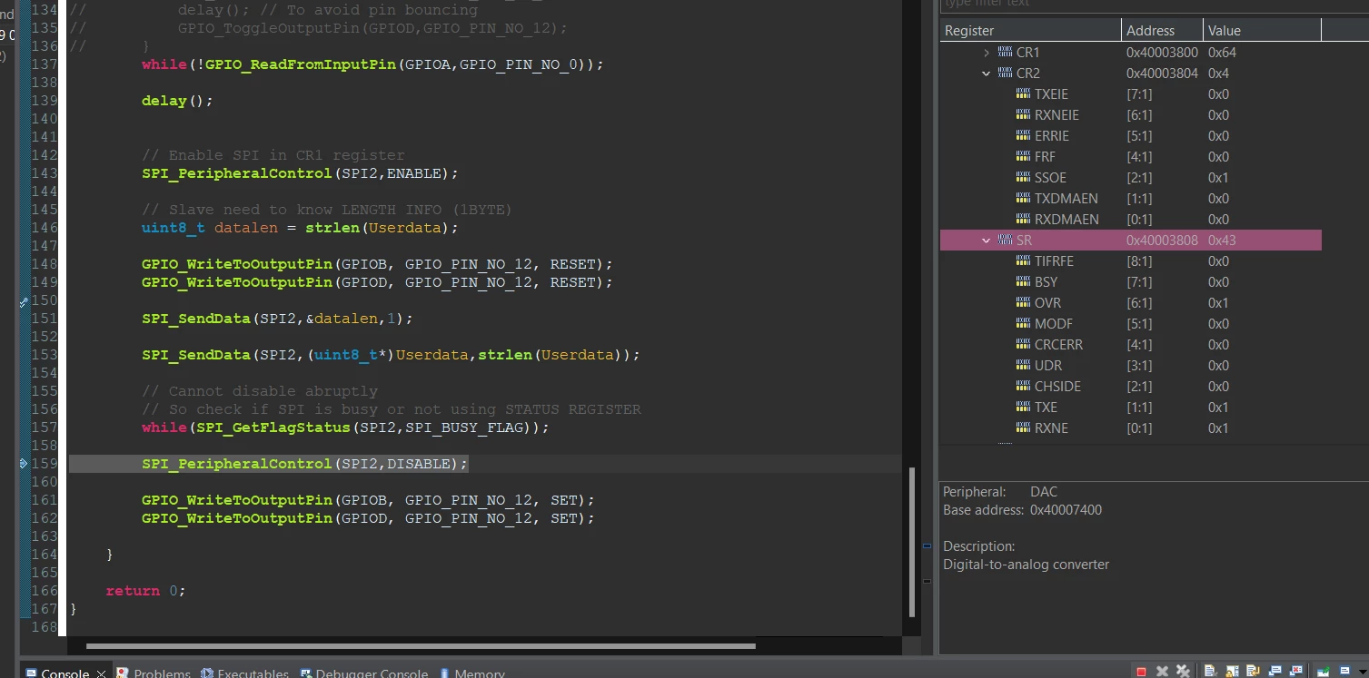

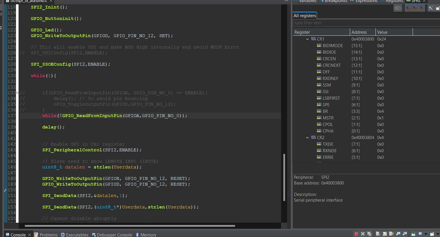

    Oct 26, 2023 11:38 AM UTC

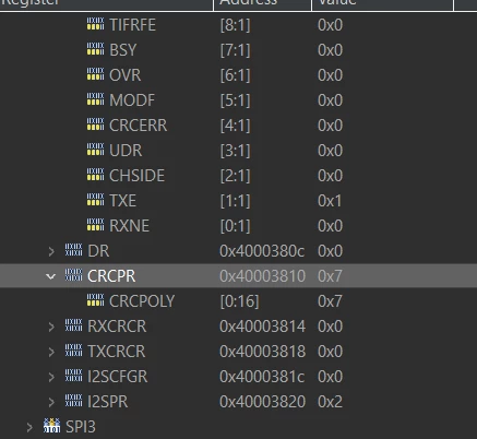

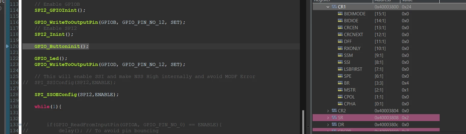

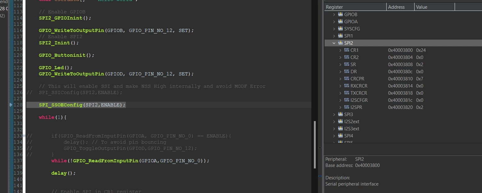

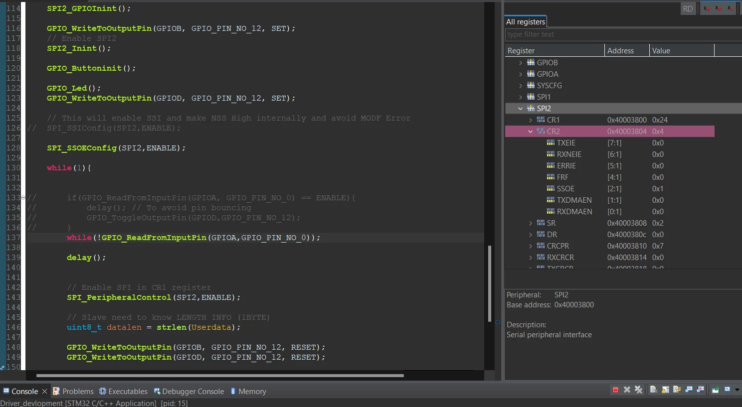

    Yes I am aware that HAL created functions for tis task but its part of what i was learning, i was learning to write Whole drivers from scratch.
    "Can you provide more to go off of than just saying it isn't communicating? Have you done any debugging or verification at all?"
    Yes So I have done a lot of debugging and searching on communities for solution but didnt find any, So while debuggging First while loop so it works fine , it loops back as expected then i checked for register values and they do seem fine, i will attach values if you want.

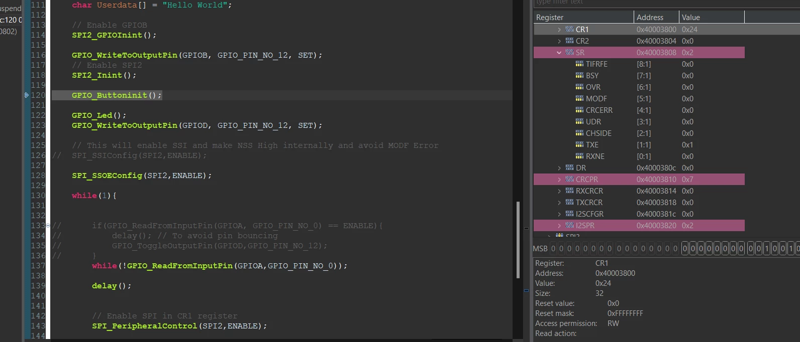

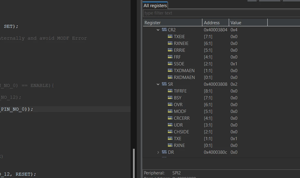

    Oct 26, 2023 11:39 AM UTC
    here are more
    Oct 26, 2023 11:40 AM UTC
    BTW i really appriciate you taking out some time for me
    Oct 26, 2023 11:41 AM UTC
    Last of it
    TDKBest answer
    Oct 26, 2023 2:53 PM UTC
    It would take me quite a lot of time to dig into the code and understand it, let alone figure out what may be the problem. I'm not sure I have that sort of time to devote, so I will provide some general advice instead:
    • Developing new drivers can be a good learning experience, but learning to use what is already there is useful as well. Especially if it's generally adopted by a large portion of the community. It's unlikely your employer will ask you to remake HAL. Perhaps they may ask you to make it faster.
    • I can see more benefit in accessing registers directly rather than making HAL-like functions. The reference manual will be a good source of information.
