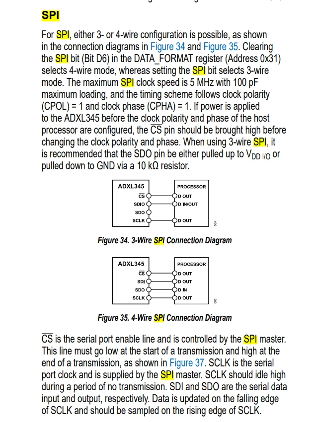

I have doubt with the spi communication setup in this configuration. I'm using two sensors where one of the sensor only support 3 wire spi and another  is 4 wire .I have a single spi in mcu. The hardware setup is followed by mapping four wire spi to mcu(mcu is configured in full duplex mode) and put a resistor between miso and mosi and given to three wire spi slave.
>Is it possible to make proper communication in this setup?
>If this is okay how the master mcu will differentiate betweeen them?

    Technically, yes. You would need to reconfigure the peripheral in 3-wire mode when you wanted to use that mode and switch to 4-wire mode for the other sensors. Not something that will be supported by CubeMX.

    1- Yes you can make a proper communication using this setup.
    Serial Peripheral Interface (SPI) allows full-duplex or half-duplex synchronous serial communication with multiple devices over 3 or 4 wires.
    For example  by checking the datasheet of the sensor ADXL345 ( Digital Accelerometer)
    2- To differentiate between the two sensors, you can use a separate GPIO pin as an additional chip select (CS) for the 3 wire sensor.
    Thx
    Ghofrane

    Is it possible to use both three wire and 4 wire spi in same spi bus? if yes how it will work?
    TDKBest answer
    January 17, 2024
