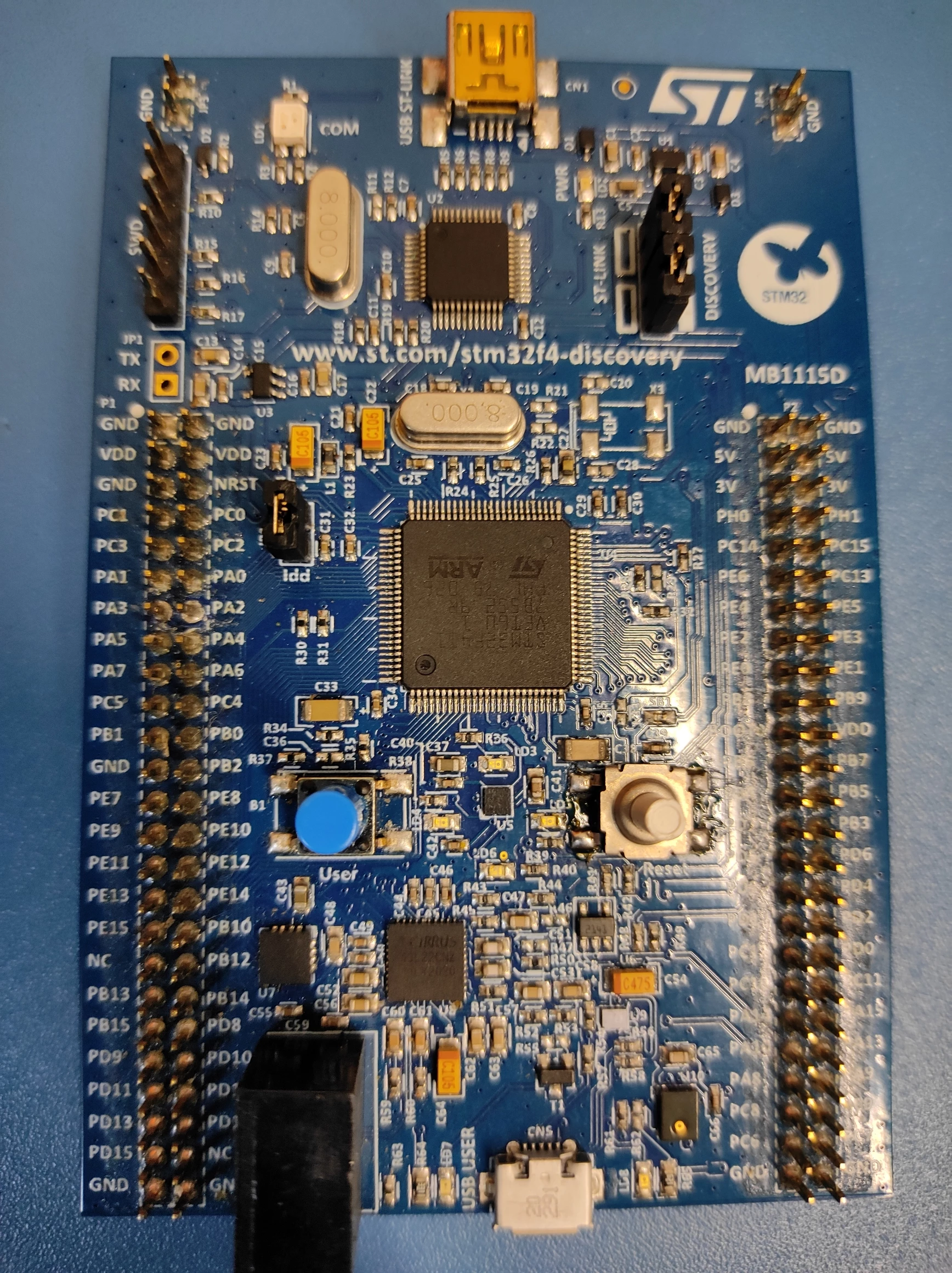

I want to start with this sensor but i am receiving
Sensor is not connected Received data from register 0x0F: 0xD3
Can anyone help me identify where I may be wrong?

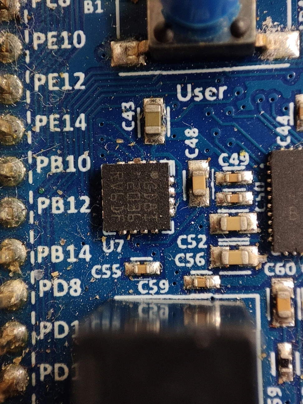

    February 12, 2024
    Perhaps the chip is not what you think it is.
    #define WHO_I_AM_L3G4200D 0xD3 /* for L3G4200D */
    What hardware is this? Post a high resolution in focus picture of the chip.
    swatiAuthor
    February 13, 2024
    I am using STM32F411VET6 and also attaching Images of the controller.

    TDKBest answer
    February 13, 2024
    Unfortunately, the markings for that sheet are not specified in the datasheet.
    I would guess it's actually a L3G4200D chip based on the register value. Perhaps there are other differences in the registers which you could examine to find out.
    swatiAuthor
    February 23, 2024
    Yes your suggestion helps me, as my sensor chip is different.
