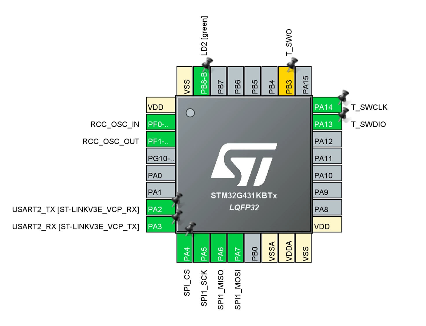

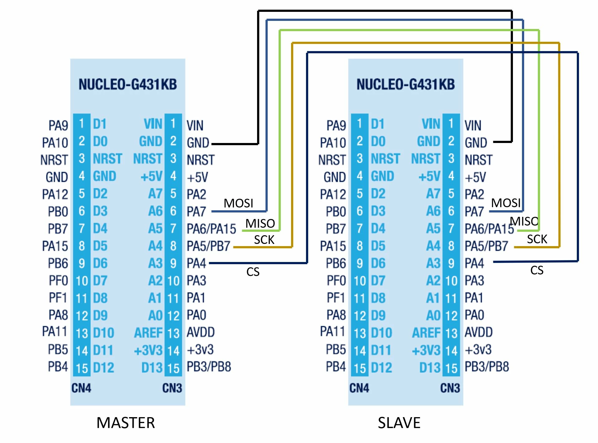

I'm getting introduced to the STM32 environment and I have been trying to use SPI protocol to send messages between these two boards. My setup is as follows:
_legacyfs_online_stmicro_images_0693W00000bjMMCQA2.pngAnd in the CubeIDE both boards have this setup, with the difference that the master board has the selection of Full duplex master in SPI and the slave Full duplex slave. The clocks are configured the same way in both boards and I believe I'm not leaving anything.

Peter BENSCH
May 4, 2023
...and please check MOSI/MISO:
  • MOSI = Master Out Slave In
  • MISO = Master In Slave Out
Currently you have connected output with output and input with input.
So you would have to cross both.
[edit]my assumption was wrong, the wiring is correct[/edit]
Regards
/Peter
waclawek.jan
May 4, 2023
I see MOSI from master connected to MOSI of slave, and MISO from slave connected to MISO of master, so it's input to output and output to input as it's supposed to be.
Peter BENSCH
May 4, 2023
Oops, you are right, Jan, I was confused with another communication.

How do you have the NSS configured for master and slave (show your MX_SPI1_Init code)? Also make sure that the slave it running (and waiting) before you start the master. Off hand I am not sure how the SPI hardware behaves if it were to start receiving in the middle of a packet. You should add a delay in the master's loop to make it easier to debug (so there is a gap between packets). And, as always, check the return values from the HAL calls - probably not an issue here but a good habit.

do you not think that you need to make the CS(chip select) pin from high to low for communication?
first, make the cs pin from high to low
and then try the same, I guess it will solve your issue if I am not wrong then.
ArnauReyes
May 8, 2023
I don't know why I didn't think about this. This fixed the communication problem, as the master is now sending messages to the slave and the slave recieves them correctly. The issue I have now is to send a message from the slave to the master.
