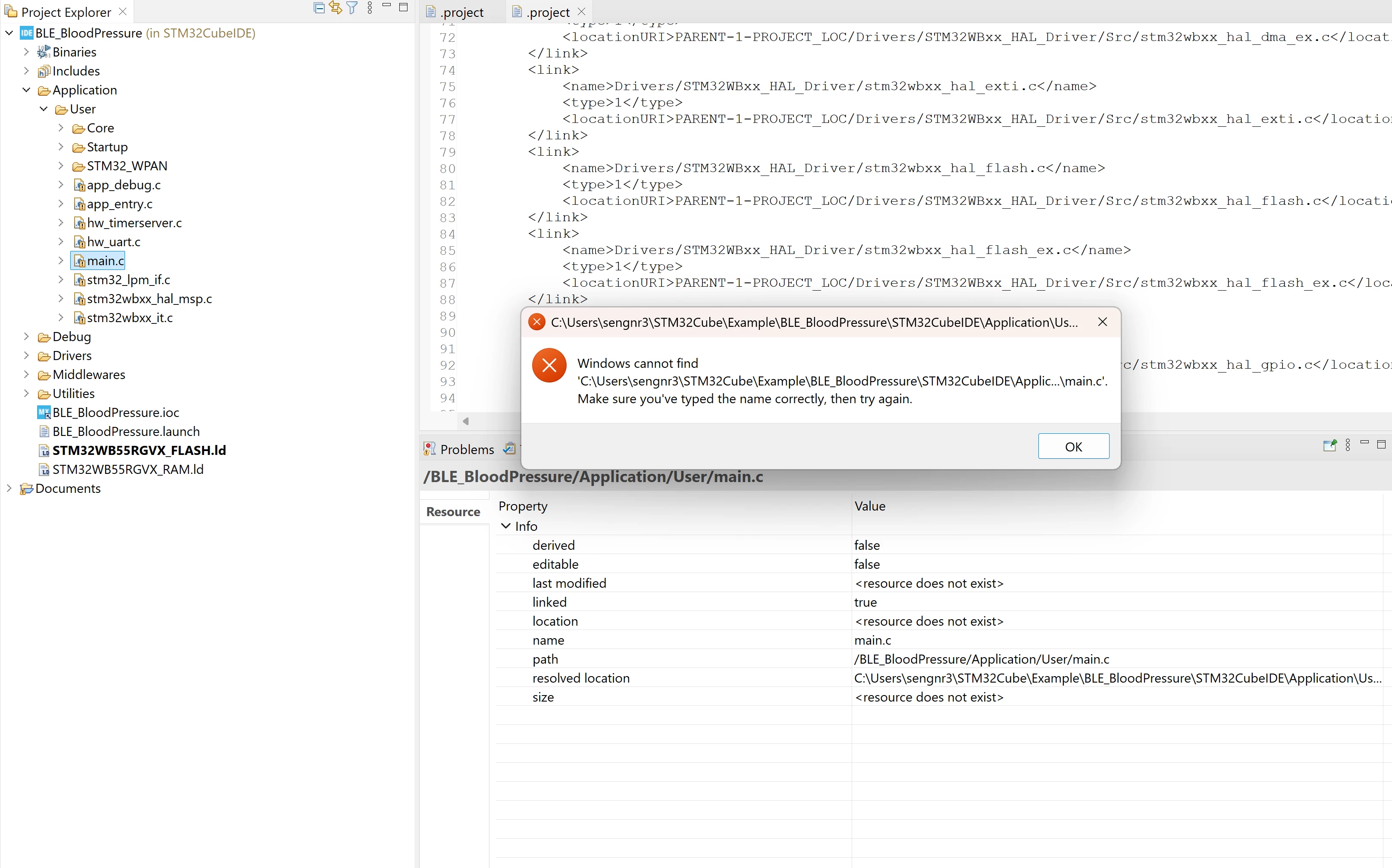

Sources missing from CubeIDE project...
STMCubeIDE 1.17.0
I opened & built an example project for the NULCEO WB55. It built successfully & download onto the board & runs as expected. But when I tried to add some functionality to the code by clicking on the file in the project navigator all the files are missing!

Andrew Neil
Feb 6, 2025 2:22 PM UTC
Are they there is you look in the Windows Explorer?

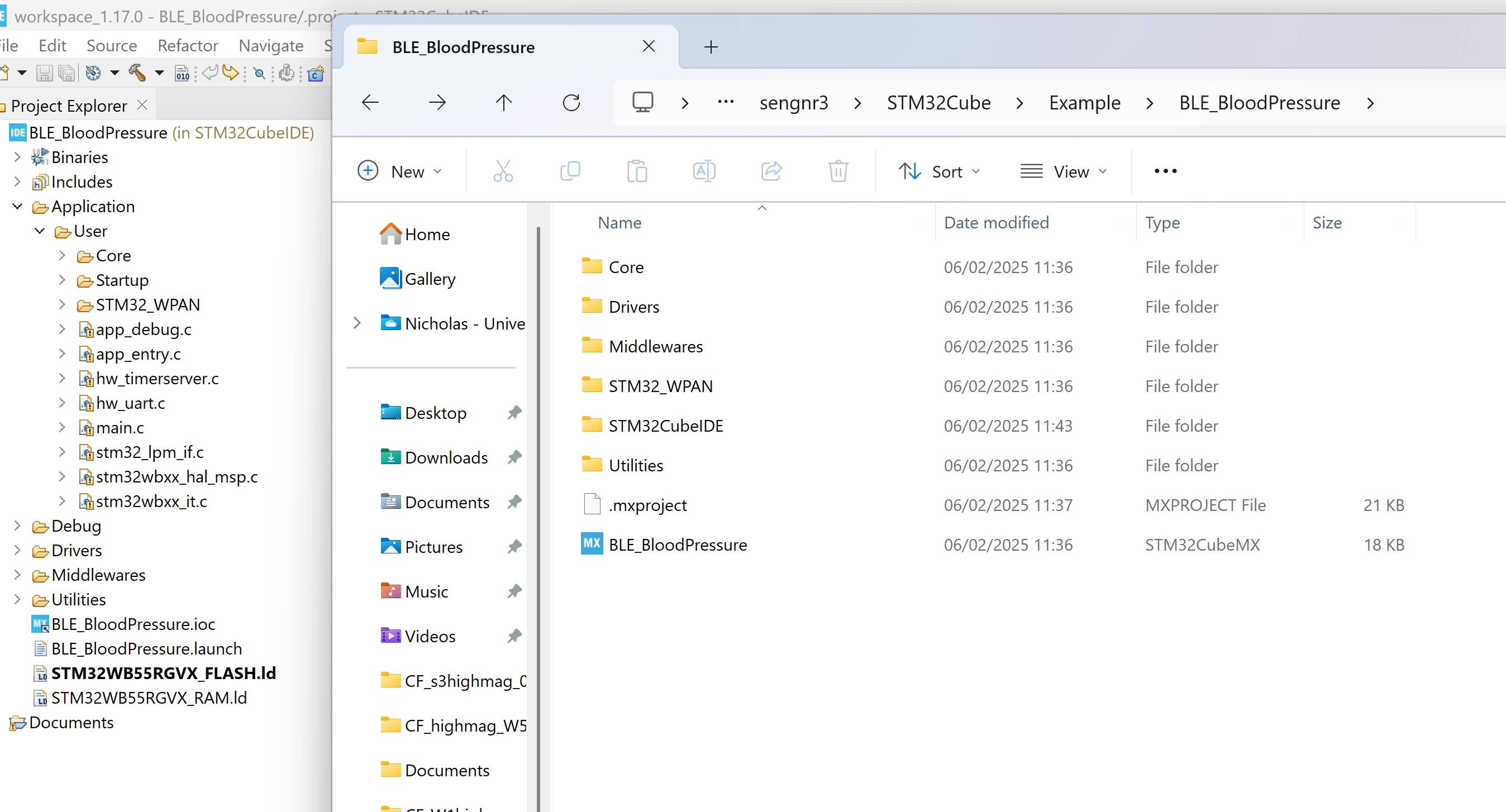

Senior III
Feb 6, 2025 2:32 PM UTC
No it looks different in Explorer
Andrew Neil
Feb 6, 2025 2:36 PM UTC
Indeed - the "folders" within the Project aren't (necessarily) folders in the underlying host file system.
But can you find the files at all ?
