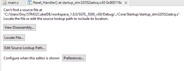

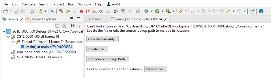

After after installing version Version: 1.13.1 (I have before the 1.8.0). I can open my Projet and compile with no errors. But when I'm in Debug mode I can't see my code but I have this message :
What does that mean ? The source file I can see :
Do you know how to proceed ?

    The error mentions path with "workspace_1.8.0" in the path, whereas your IDE image says "workspace_1.13.1" in the path.  Where are the files REALLY located?

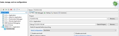

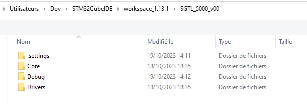

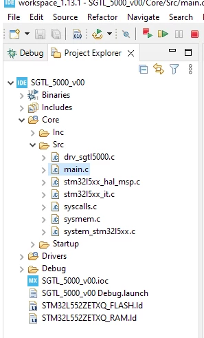

    The file is located in the in the workspace_1.13.1 :
    I think for the first time I created this project under version 1.18.0 and when I make a copy to put in the 1.13.1 directory it still sees the dependency initially created. So how to how to open under workspace_1.13.1 ?

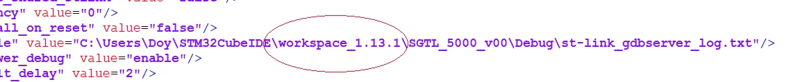

    can you import the old (1.8) project?
    An if it not work:
    look at the ".launch" file with the editor and replace all "1.8.0" with "1.13.1"
    HTH

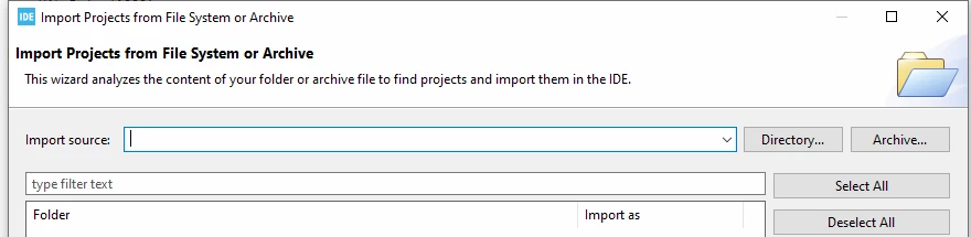

    What do you mean import the old projet ? I suppose under STMCubeIDE (1.13.1) I import the old projet probably ? I encounter this screen
    So what should I select please ? Thank you for your answer. I can guess your message at the bottom right of the screen I can select this directory
    And I can see the projet like this picture :
    I can compile without errors but always the same screen when I'm in DEBUG mode :
    I also modified the .launch file to 1.13.1 but I still have the same error.

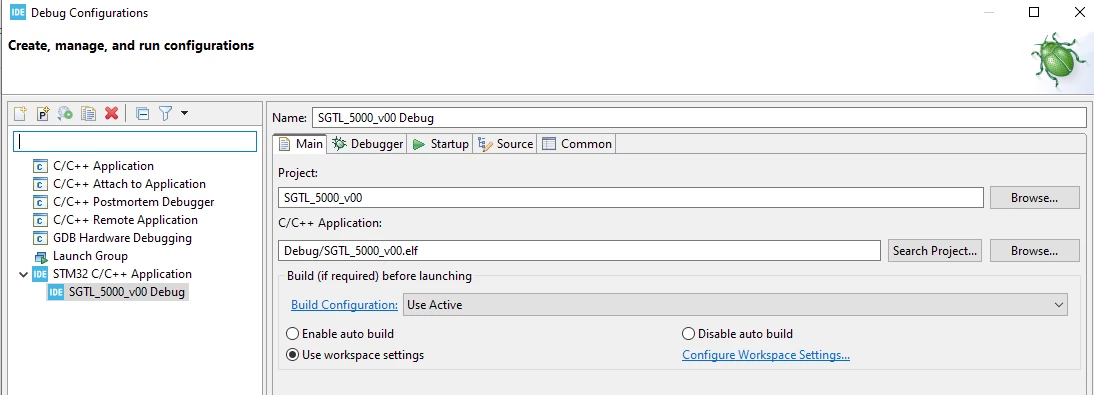

    Take a look at
    Use the "searchProject" or better "Browse" to your
     "debug" and there select the .elf file.
    it seems that there is an old path in the config....
    hth
    Padawan
    to get the right elf file.

    What happen if you click on "locate the file"? Can you see your .s File?

    Always the same error :
    I can see always the path workspace_1.8.0/SGTL_5000_v00/Debug.....

    I think you have to search your .s file in the startupfolder bleow debug.
    if there more than 1 .s file delete them.
    Another tip
    May be it helps.
    May be a reboot can help.
    May be save your work (zip) cleanup (delete the workspace) unpack you work in a dir on the dDesktop and import his dir  by "Open Projects from File system".
