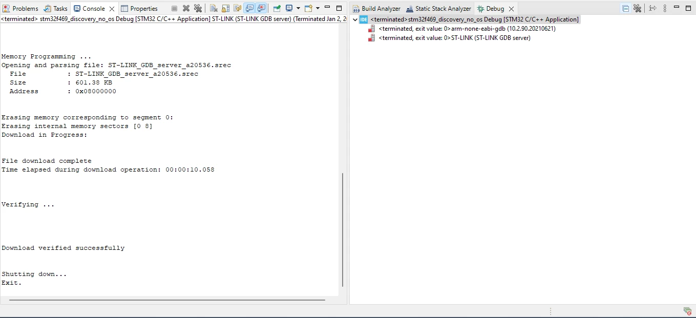

Something wrong with my gdb in stm32cubeide
0693W00000Y7CANQA3.pngWhen i run my code, something wrong with the gdb (like in the picture). Someone can help me pls?

It is a normal behaviour when making run. If download is verified successfully, GDB session will be terminated that's why you see "terminated arm-none-eabi-gdb" in the debug window.

What's in the console?
BAl K.1
BAl K.1Author
January 2, 2023
0693W00000Y7CHsQAN.pngIt says download successfully, is it run properly or not (with terminated arm-none-eabi-gdb)??

Rim LANDOLSI
January 3, 2023
Hello BAl K.1,
Are you sure you are using the right debug button looks like you are using the run button?
BAl K.1
BAl K.1Author
January 3, 2023
Yes, i use run button, i want to run the code and that error appearing. is there any solution for that??
Rim LANDOLSI
Rim LANDOLSIBest answer
January 5, 2023
