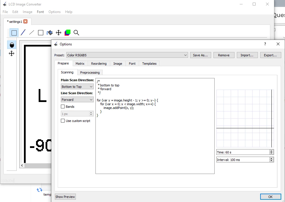

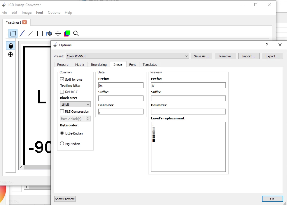

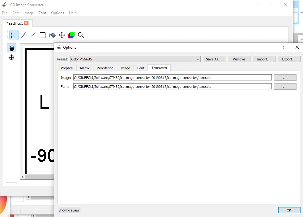

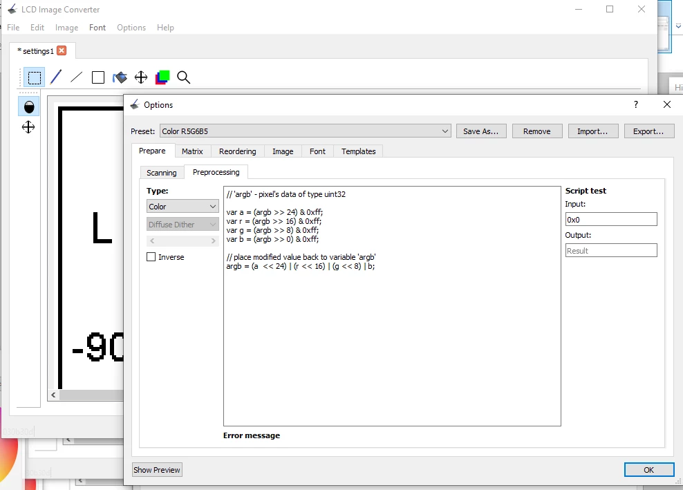

I have used the lcd-image-converter.exe to convert the bitmap files to a bitmap structure to pass to BSP_LCD_DrawBitmap().
Here the settings used for cd-image-converter.exe.

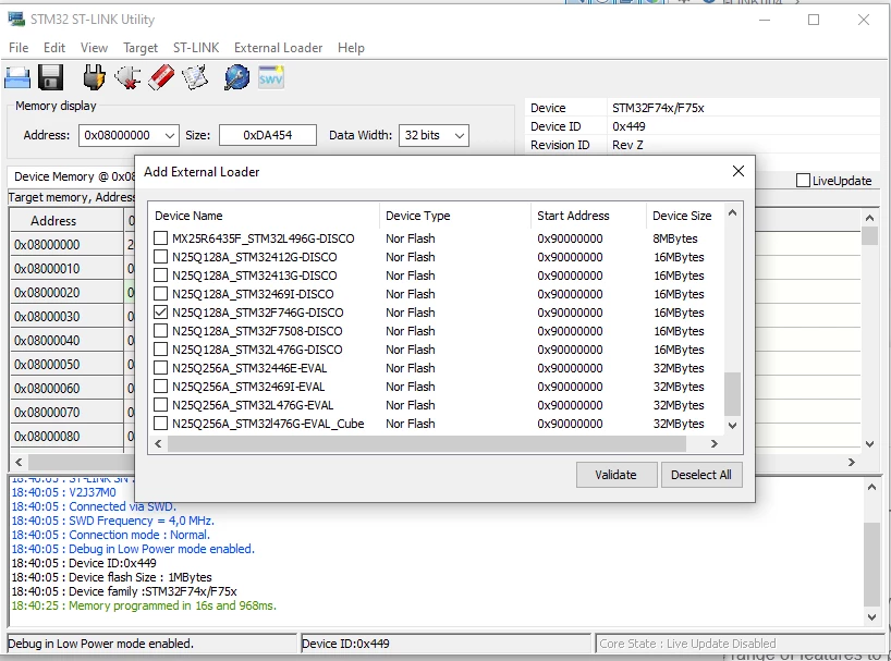

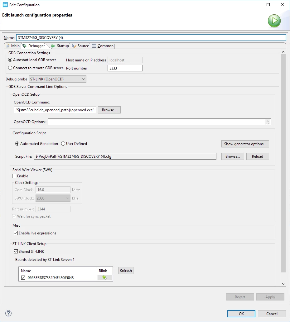

Install ST-Link Server and set these options in Project/Properties/Run-Debug section
0693W000006FZbLQAW.pngor use the external ST-LINK app with this set
