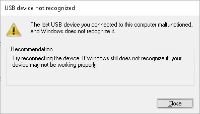

Hi friends,
Did anyone of you manage to get STM32F103C8 USB VCP working through Cube eventually?
If you did, I really appreciate it if you share a minimum Cube project that only demonstrates simple communication over VCP in Cube.
I keep receiving "Device malfunctioned" message from Windows on connecting my board.

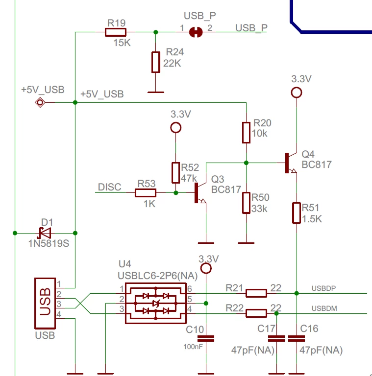

seppeltronics_v
November 9, 2020
same with the STM32H745 on a nucleo-board. I'm also Looking for a minimum project that works with VCP. I got an older OlimexBoard with the STM32F103, it wasn't even showing the error-message when plugged in.

EMiha.1
Visitor II
November 9, 2020
When you connect the USB cable, do you hear the windows USB connection sound?
If yes, and then you receive an error, then I have the same situation.
If you do not even hear the USB connection sound, then it means you forgot to activate the bus pull-up (it is usually an output digital pin that you should SET in order to activate the connection).

seppeltronics_v
November 10, 2020
nice tutorial, it solved my issue with the STM32F103 on my Olimex-Board, not it connects. The issue was very simple:
Pin 53, DISC, controls the 1.5k Pullup. Once I configured it correctly and the pullup was active Windows detected the device and the STM32-P103 (Rev.B) Board showed up as a VCP. With a terminal I was able to receive Strings.
HAL_GPIO_WritePin(GPIOC, DISC_Pin, GPIO_PIN_SET); // Make sute the DP+ is pulled up
