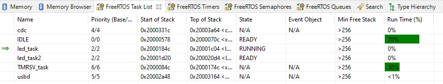

I'm currently trying to configure FreeRTOS task aware debugging. It mostly seems to be working, however, I cannot get the Min Free Stack, Event Objects or State columns fully working on the Task List Tab. The image below displays the current state. I want Min Free Stack to display Stack Usage and the Event object to not display nothing or N/A as per https://my.st.com/resource/en/user_manual/dm00629856-stm32cubeide-user-guide-stmicroelectronics.pdf

I'm using FreeRTOS V10.4.3 with an STM32H743II. I have a JLink debugger and am using STMCubeIDE 1.6.1.
Does anyone know of any issues here or know how to debug this issue further and see what the plugin is actually doing?

Upgrading to STM32CubeIDE 1.7.0 fixed the issue.
