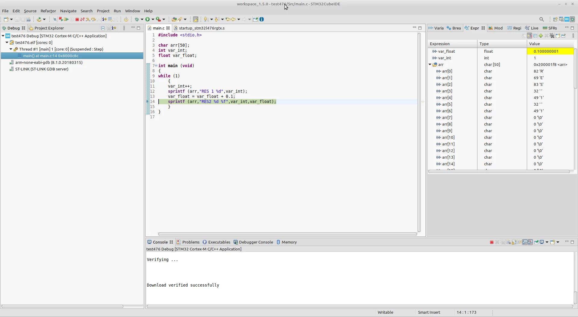

I'm trying to use this C code
#include <stdio.h>
char arr[50];
int var_int;
float var_float;
int main (void)
while (1)
	var_int++;
	sprintf (arr,"RES 1 %d",var_int);
	var_float = var_float + 0.1;
	sprintf (arr,"RES2 %d %f",var_int,var_float);
on STM32L476 nucleo kit, with STM32CubeIDE (Version: 1.5.0 Build: 8698_20201117_1050 (UTC)), I'm using debugger, stepping the code and observing variables in expression window, however the code always fails at second sprintf call (the one with float variable). Before trying to execute second sprintf call I can see proper output from first sprintf call, as well as float variable with proper value

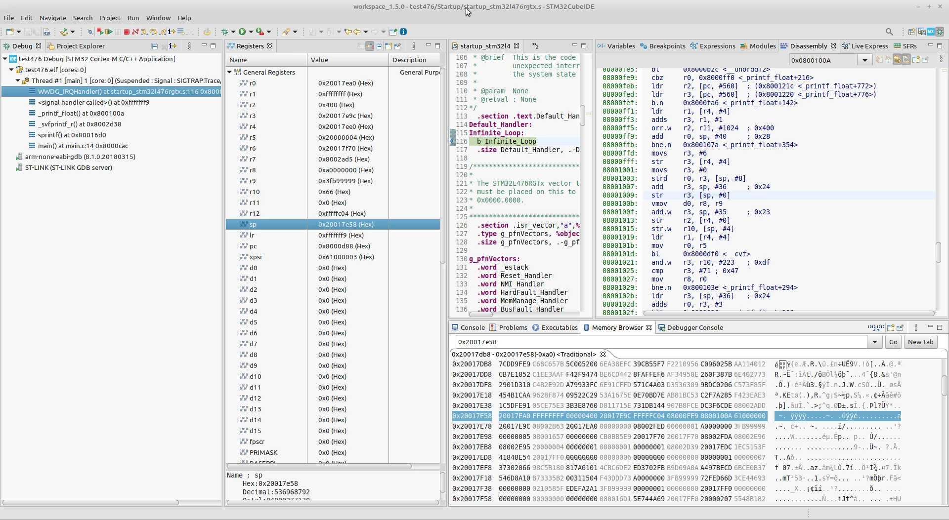

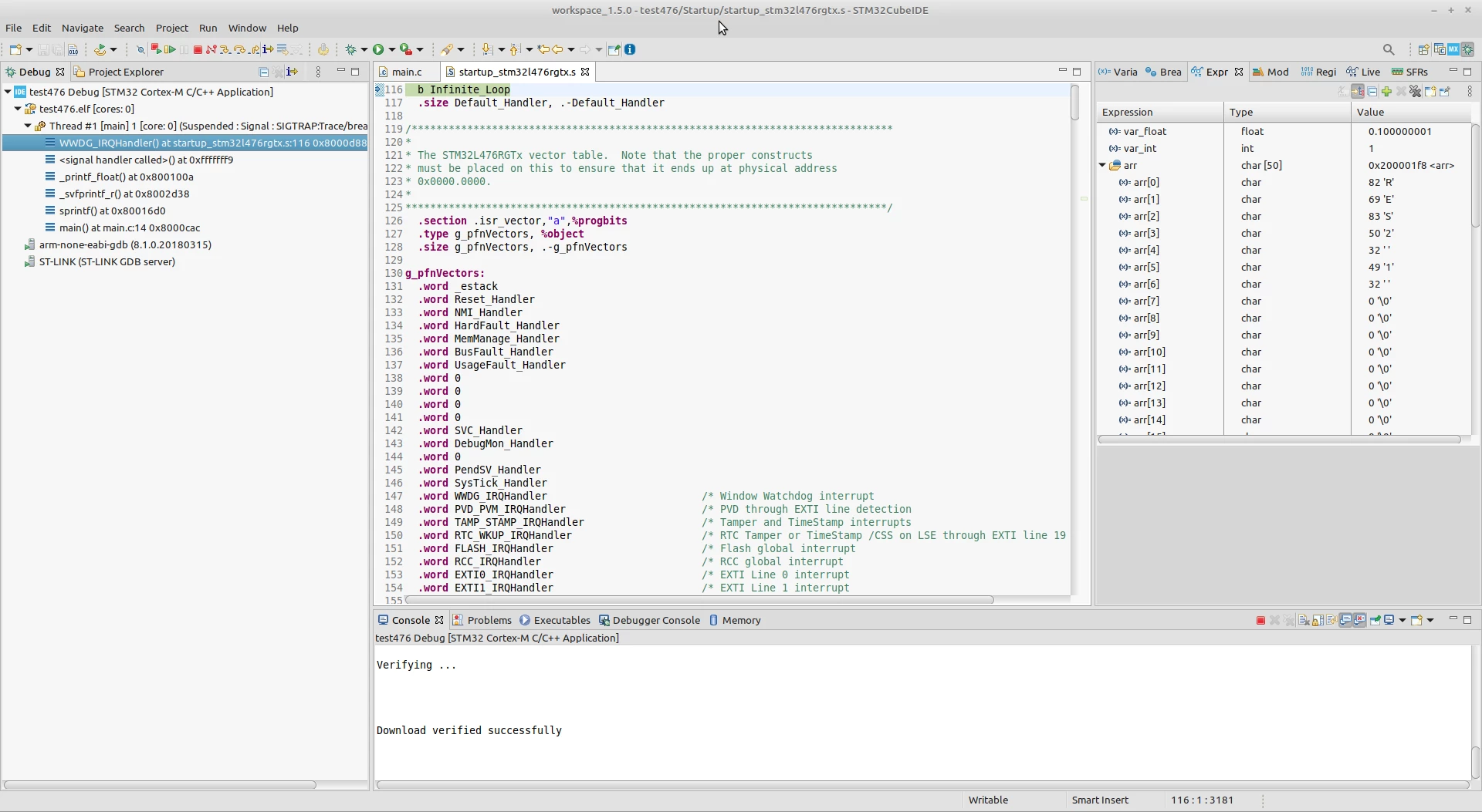

0693W00000GYFKSQA5.pngbut after second sprintf call I find the MCU executing endless loop after fault. The second sprintf managed to print output up to the floating point part.

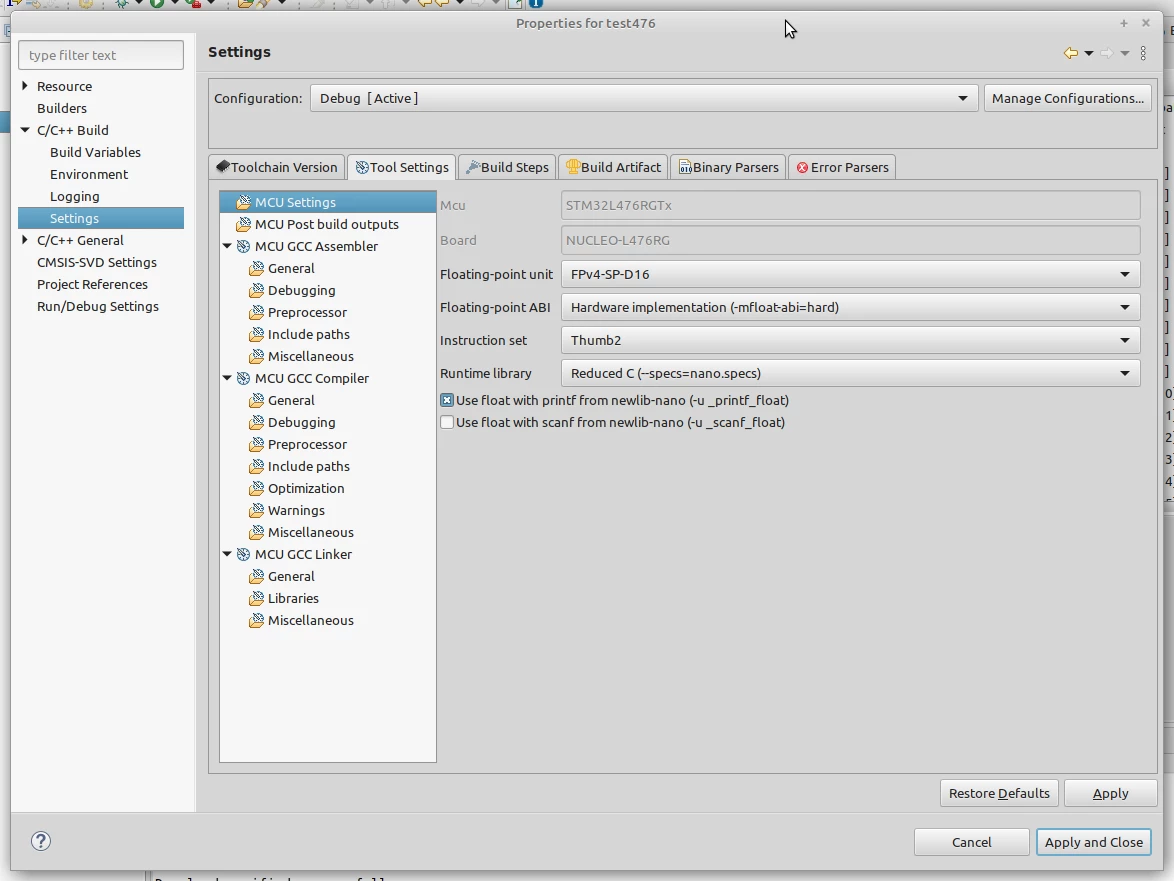

0693W00000GYFJyQAP.pngI started fresh project for this, didn't modify linker file nor any project settings, with exception of ticking "Use float with with printf from newlib-nano"

I tried the same source, with the same project setup modification (single checkbox to use float functions) on STM32F091 nucleo kit, where it works as I expect (second printf doesn't crash and prints desired output to char array).

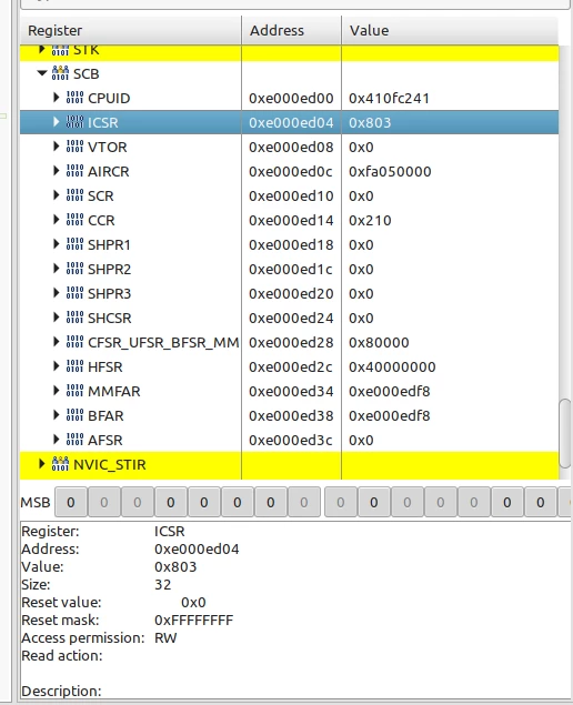

Yes, those are valid points, thanks. I tried to examine the MCU state at the fault state.
0693W00000GYGsHQAX.pngBit 2 in LR is 0, therefore main stack was active at the exception moment, SP points to 0x20017e58, examining this part of memory reveals PC at address SP+0x18, that is 0x0800100A. Disassembly window shows 'vmov   d0, r8, r9' instruction at this address, inside _printf_float function.
vmov makes sense in this context - moving between VFP and registers. R8 and R9 values looked benign to me. While I was at it, I checked CPACR
register and found it's all zeroes, so that FPU wasn't even enabled. I was apparently using wrong version of startup code. After enabling the FPU code works as expected.

You're showing it in the Default Handler
Get a proper Hard Fault handler, and look at what's actually faulting, the processor registers at the fault, and the immediate and preceding instructions.
Are you sure it's not a Division by Zero, Usage Fault?
jaromir sukuba
November 19, 2021
That is good observation, I was a bit too quick and didn't show VECTACTIVE bits in SCB->ICSR, set to 0x03, pointing indeed to Hard fault.
I have no sources for library *printf functions in my project to step into and take a look at offending piece of code.

Read VECTACTIVE bits in SCB->ICSR to determine what interrupt it is in. As Tesla says, that is not the hardfault handler.
jaromir sukuba
November 19, 2021
VECTACTIVE bits in SCB->ICSR read as 0x03, therefore it should be indeed hard fault vector.
