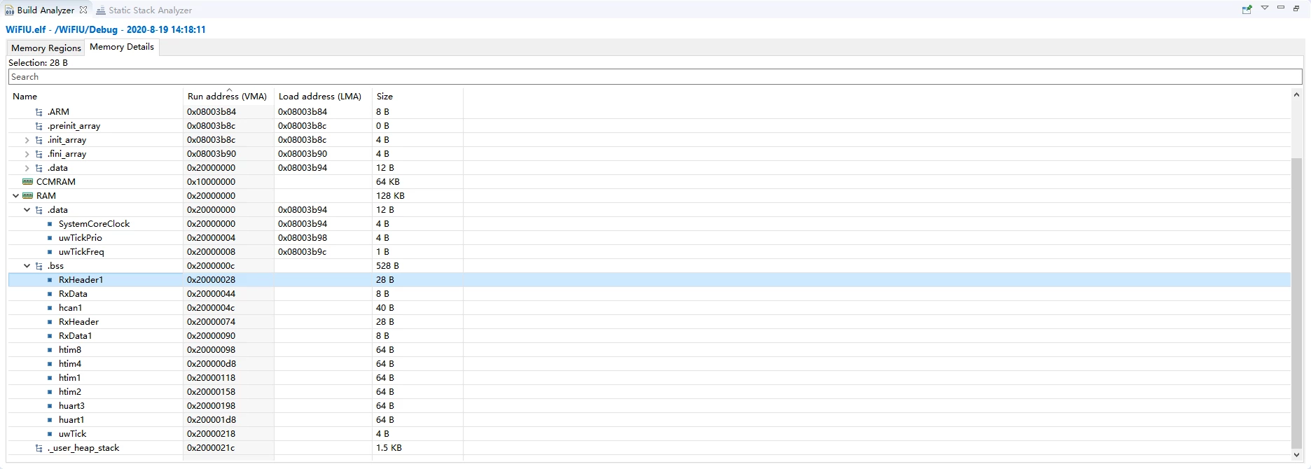

solution or tool for memory information export
is there any solution or tool for memory information export to text file as followed window shows.

It is possible to copy and paste from the Memory Details tab in Build Analyzer.
More info in the STM32CubeIDE User manual which can be found here:
https://www.st.com/resource/en/user_manual/dm00629856-description-of-the-integrated-development-environment-for-stm32-products-stmicroelectronics.pdf
Please read section 7.2.2.6
