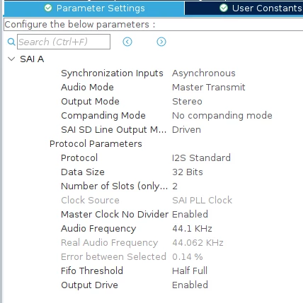

    >Yes but I don't understand where I could "slow" the code down
    The audio speed (= sample rate) is set by the SAI master and what you set it to.
    in Cube:
    then start it, from now its continuously running... (Check with scope the signal, word clk...to prove your setting.)
     fresult = HAL_DMA_Init(&hdma_sai1_a);
    fresult = HAL_SAI_Transmit_DMA(&hsai_BlockA1, (uint8_t *)playbuf , (sizeof(playbuf))/4);// SAI start
    (playbuf is int32_t here, because i use 32b sample format, so you might adjust for int16 )
    Then just feed it in half/full callbacks - thats it, to get it running. :)
