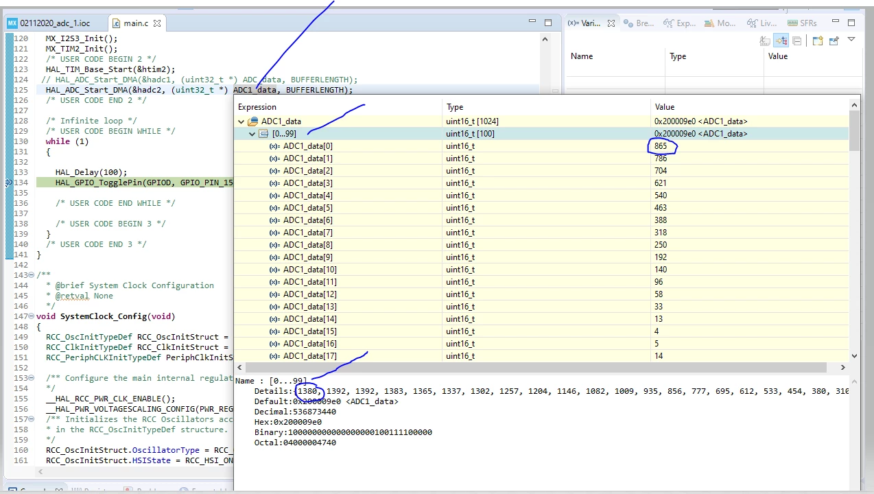

Simple stupid question ...Why are the VAR not same value ?
Hi guys
Why are the ADC1_data[0] = 865 when looking on the var but in the lower part of the picture it says DETAIL 1380 ???
i do sample a sinoid so think the lower part is the right one....

Perhaps because the ADC/DMA are continuous and ongoing..
November 3, 2020
Both sections seems sinusoidal. Is your DMA in circular mode?
