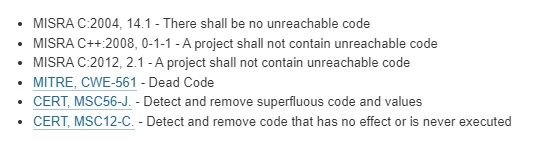

    For more information, here is the SonarQube rules :

    There are severals "norms" about compiling C code around the world and epoch.
    Yours seems to unaccept unreachable code. This is just a detail.
    Later in your project, you will probably add some conditions to exit this while loop, and so you will have to add a return statement in your function.

    Here, its not about code quality, but about follow the norms of your compiler.
    Pavel A.
    February 26, 2024
    Since C99, int main() does NOT have to return anything. Now you can understand why they made this improvement ))

    But I'm annoyed with the fact that the main method doesn't have the "good" return type.
    Int is the perfect return type for main(). The good practice? Before taking on a project, verify which language version and coding guidelines should be used. Refresh your C. Read documentation. Repeat every so often.
