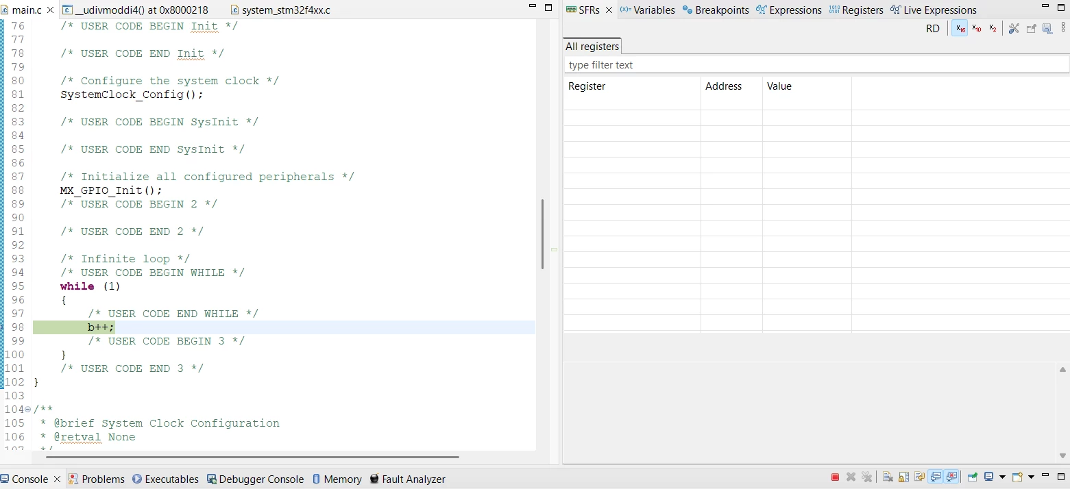

SFRs are not shown in the STM32CubeIDE in Debug mode
STM32F411CE microcontroller.
I created a starter project via STM32CubeMX using HAL and opened it in STM32CubeIDE. When I run this project in debug mode, the SFRs tab is empty (see figure bellow). Why?
When I create a project without using STM32CubeMX and, accordingly, without using HAL, the SFRs tab shows the registers and value of registers.

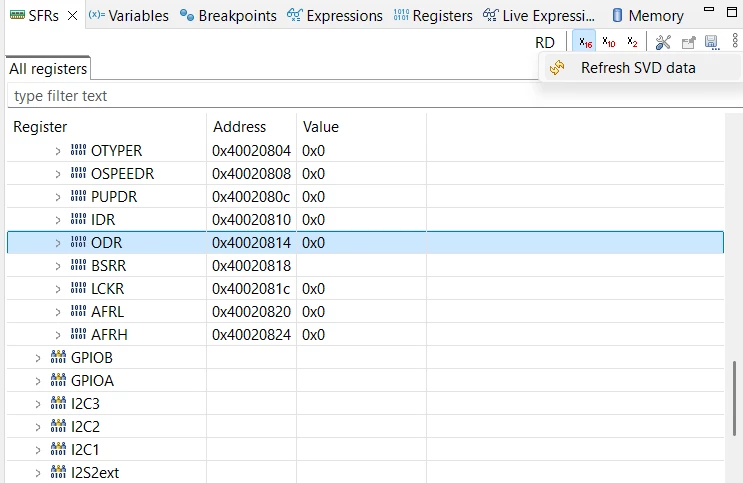

Hello @Ghofrane GSOURI ,
The problem was solved. It was necessary to click the Refresh SVD data button in the SFRs tab (see figure bellow).
Refresh SVD data button locates in the SFRs tab:
    1. Navigate to SFRs tab;
    2. Click on the 3 dots icon in the SFRs tab;
    3. Click Refresh SVD data.
After that, the registers and their values ​​appeared in the SFRs tab.
