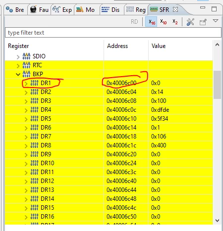

Processor: STM32F103
Using the SFR view in STM32CubeIDE, address 0x40006c00 is used for Register DR1;
looking into the software implementation this is actually 4 bytes before the DR1 register, resulting in a shift of DRx register by one.
Also according RM0008 the first 4 bytes based on above offset are reserved.
RN0114 (release notes for STM32CubeIde) are not mentioning this topic.0693W000003PGw3QAG.png
Implementation with HAL (for DR1 value 1 is handed as BackupRegister, resulting in an offset of 4 Bytes) :
uint32_t HAL_RTCEx_BKUPRead(RTC_HandleTypeDef *hrtc, uint32_t BackupRegister)
 uint32_t backupregister = 0U;
 uint32_t pvalue = 0U;
 /* Prevent unused argument(s) compilation warning */
 UNUSED(hrtc);
 /* Check the parameters */
 assert_param(IS_RTC_BKP(BackupRegister));
 backupregister = (uint32_t)BKP_BASE;
 backupregister += (BackupRegister * 4U);
2 replies

Similar: https://community.st.com/s/question/0D50X0000ALwiivSQB/stm32f107-bkp
@Imen DAHMEN​ , can this please be fixed?

Thank you for the feedback!
We take note of this and will be fixed asap.
