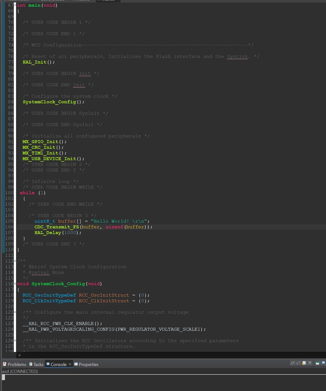

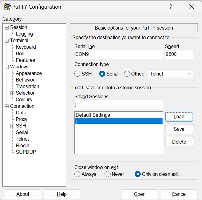

Ok I disabled the rtos, but the behaviour is still the same... I also placed a screenshot of my putty settings.

AScha.3
May 30, 2024
Ok, it should work now.
Just...with putty i had no luck, to get/see something from USB/CDC .
Did you check with any other usb->serial transmitter , that you get the text ?
I use terminal program, like gtk-term .
You could also open a "command shell console" in IDE , menu -> window -> show view -> console :
then > command shell console , set your port+speed , and see ...
(maybe need : unplug and plug in the usb cable, to start your program + enumeration new.)
LeboisAuthor
May 30, 2024
Still no luck...
I tried hercules, and i tried the console integrated to the ide... Also tried to switch ports

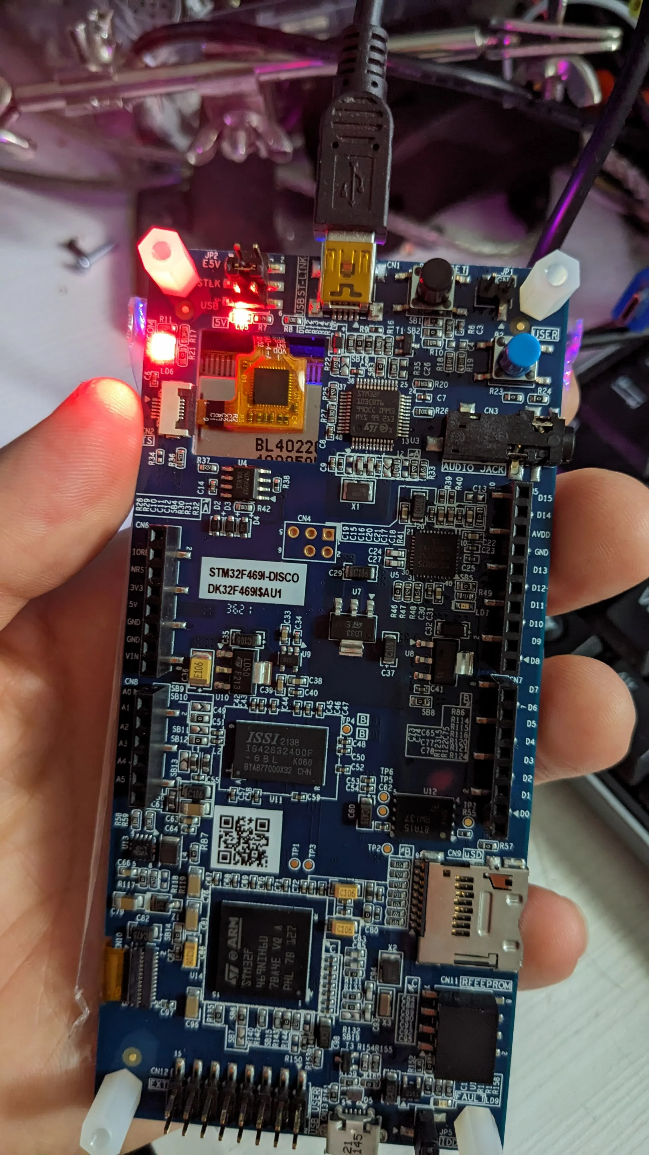

LeboisAuthor
June 3, 2024
Still nothing. The board is correctly connected because I hear the ding  dong and it shows in the device manager.
In attachment I put a picture of how the board is connected.

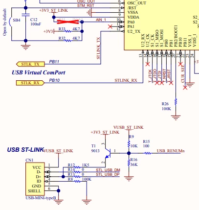

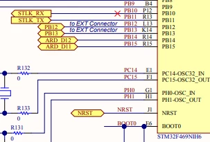

AScha.3
June 3, 2024
So from pic : you use F469-disco , connected to USB -> st-linkV2 onboard .
This connects to PB10/11 on F469 :
So you have not connected to user-USB , but to st-link VCP (on uart rx/tx ).
To send on this connection, you have to look : which uart you connect to PB10/11 and set its speed to 115k/8n/1 .
(probly : usart3 )
(If using Cube -> start with "board xxx" , it will pre-set the serial , just look, to check it.)
Then send with:
 HAL_UART_Transmit(&huart3, (uint8_t *)&ch, 1, 0xFF);
