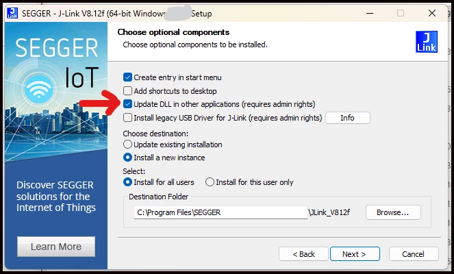

Segger J-Link STM32H755 CM4 debugging in STM32CubeIDE
I am trying to debug the STM32H755 within CUBEIDE but the current segger J-link drivers say that core is not supported. The segger website lists it as supported and it works without issues in their debuggers.
I am wondering if there is a workaround or way to get it working with the CM4 core?
CM7 works as expected.

Pavel A.
Feb 13, 2025 9:36 PM UTC
IIRC when you run the updater of J-Flash, it automatically finds J-Link modules (DLLs) installed in other software and updates these. Try it. Chances are it will update your CubeIDE.
Ckerl.2
Ckerl.2Author
Feb 14, 2025 5:33 PM UTC
Hi Pavel, how do I run the J-Flash updater? just running the Stm32cubeide J-Flash program doesn't seem to start any update.
Is the updater in cubeide menus? or is it a program or script in the external tools jlink folder?
Thanks!
Pavel A.
Feb 14, 2025 7:53 PM UTC
@Ckerl.2 Download and run latest J-Link installer from Segger https://www.segger.com/downloads/jlink/
(this is a bit confusing: the J-Link installer installs a large set of various programs and utilities. Some of them are interesting and useful, others less so).
