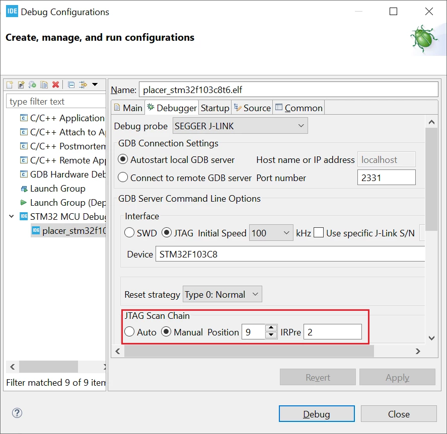

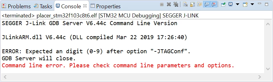

SEGGER J-Link, -JTAGConf option fail
Hi.
I get this
What should I do?
Thanks

Perhaps try with 1.01 rather than try to re-litigate failures in old versions.
Tesla DeLorean
Guru
July 2, 2019
If still failing in 1.01 flag to @Markus GIRDLAND​
APhoe
APhoeAuthor
July 2, 2019
Ok, thanks. But it still does not work. @Markus GIRDLAND​

good news:
With CubeIDE 1.5.0 its now possible to start a debug session with JTAG chain options manually configured.
Anyway, think about to use Seggers Ozone Debug tool, its much faster when debugging.
