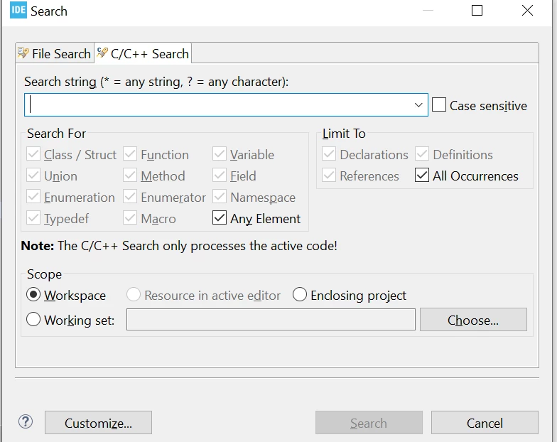

"Search" is not working in the STM32cube ide
Hi ,
I am using the STM32 cube ide 1.12.0 version and the "search" CTRL+H was working earlier .Now this is not working .
I have used the shortcut key ALT+SHIFT+Q+S still not working ..

    Happened to me earlier as well. Try the following.
    Try to reset the views by going to Window->Perspective->Reset Perspective. Then, Window-> Show view-> Search
    Hope that helps.
    Explorer II
    February 27, 2024
    Worked for me as well)
