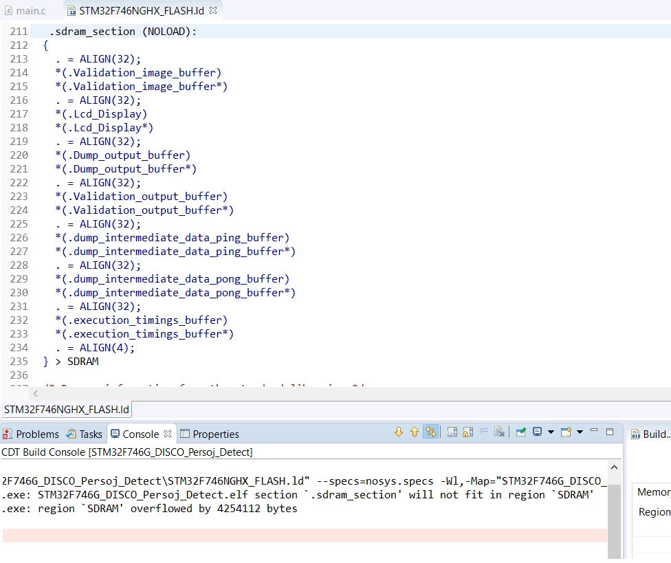

Hello everyone,
I faced an error with my .ld file. the .sdram_section will not fit into the SDRAM (8MB)
how to solve this?
thanks
That's not problem with the .ld file, it's a problem with your program. You try to put too many things into the SDRAM.

How to solve it then?
waclawek.jan
August 15, 2020
Reduce the number of data you are trying to put it in there.
How do you solve if the files won't fit onto your USB FLASH stick?
How do you solve, if the baggage won't fit into your car?

Yes but I can’t, If i do so, I’ll lose data and then the image on screen will be whatever

Figure out why you need 12MB+ of RAM
What are you using it for?
Can you fold any of the usage? ie does it all need to be used concurrently, or could it be shared or allocated dynamically.
Put static images into QSPI Flash.​
