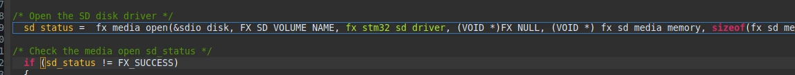

Hi @AScha.3 ,
from the screenshot, you seem to have enabled the fault tolerance in FileX  is that the case?
is there any reason to enable it?
regards
Haithem.
AScha.3
AScha.3Author
Oct 10, 2023 5:05 PM UTC
Hi @Haithem Rahmani  ,
this was my last idea, what could help this MS**bleep** to get it working.
But first, thx to look+write here , i already was thinking, STM no more has much interest in any problems of customers or users...
But anyway, i kicked out this MS excrement. not working at all...imagine : the company , that was "creator" of fatfs, makes program (or STM spoils it ? ) that cannot work with fatfs systems... tragedy. or almost comedy level.
Now , after debugging 5 days this nonsense, i just copied in Mr. Changs fatfs ( Generic FAT Filesystem module R0.15 , not the 6 year old version, that STM still has in Cube) and it worked instantly . So i will try to use this.

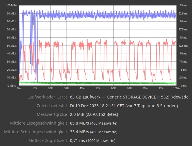

When looking (on my audio player) continuous data block reads, 16kB, there are "magic" differences between cards:
- the Kingston canvas select : this type should be top, read at >80MB/s
-- using 32GB version shows 0,7..1,2 ms time to read 16KB
-- using 64GB version shows  1...40 ms time to read 16KB
Maybe i got a bad, bad example (have only one of this cards) here, but i tested with speed test on linux and see:
so it can read at 90MB, but sometimes --- bad dropouts.

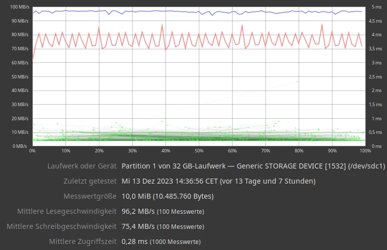

Compare a SanDisk extreme , 32GB :
THIS card reads at 96MB/s -- always.
I think, this is a very important difference, showing a little the "internal" quality of the flash area.
Also the write performance is very different: the Kingston card writing at 50 or 5 (!) MB, alternately (!) ,
the SanDisk at 80 or 70 MB .... rate the drama yourself.
