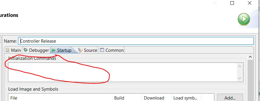

I flash a project for debugging and set some breakpoints. Then I compile for release and run the code using the green arrow symbol. The code is flashed, but does not run, as it is stuck in a breakpoint from earlier debug sessions.
Is there a way to automatically remove all breakpoints in the device when starting a "Run" configuration?

thanks, but no, this removes the breakpoints in the IDE. I want to keep the breakpoints in the IDE for debugging, just clear them from the device memory when running a release version. I guess there should be some initialization commands in the run config, but I don't know which commands are available there.

no no. I assume the breakpoints are somehow still in the memory of my stm32. during "run", I don't want them there, only during "debug'. So if I click on run, the breakpoints can still be in the IDE ( I might need them again in next debug session), but they should be removed in the stm32 during run.
I hope that makes it a bit more clear ;)

I never inserted software breakpoints, so how can I make gdb delete all breakpoints when I want to run release?

I just wanted to have the breakpoints automatically cleared once I start a run session. I thought there were some simple init commands in the run config. Other IDEs do this automatically anyways. Of course I can always disable them manually and then start the run session.

yep. so what are the commands you can enter here? Is there any kind of docu for that? is it GDB commands?
