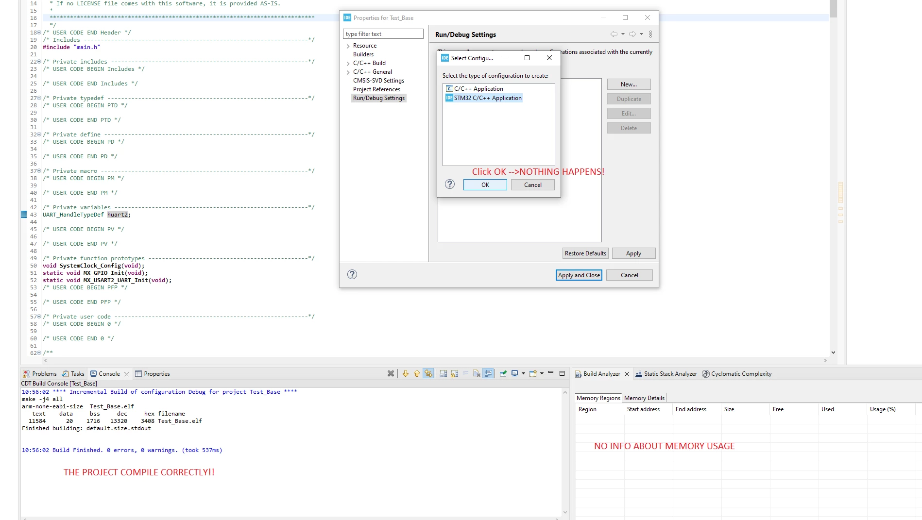

I've STM32CubeIDE v1.14.1 on a Windows10 PC. I've NUCLEO-G0B1RE board and I've created my workspace with a standard project starting from the NUCELO ioc configuration. I can build the project and upload the .elf file on the uC with STM32CubeProgrammer software, no problem, it works.
When I try to Run or Debug the project from the STM32CubeIDE, nothing happens; also if I try to add some lauch configuration from Properties->Run/Debug Settings menu, nothing happens......
Another strange thing is that in the Build Analyzer tab I have no info about memory usage....
Is there a way to solve?

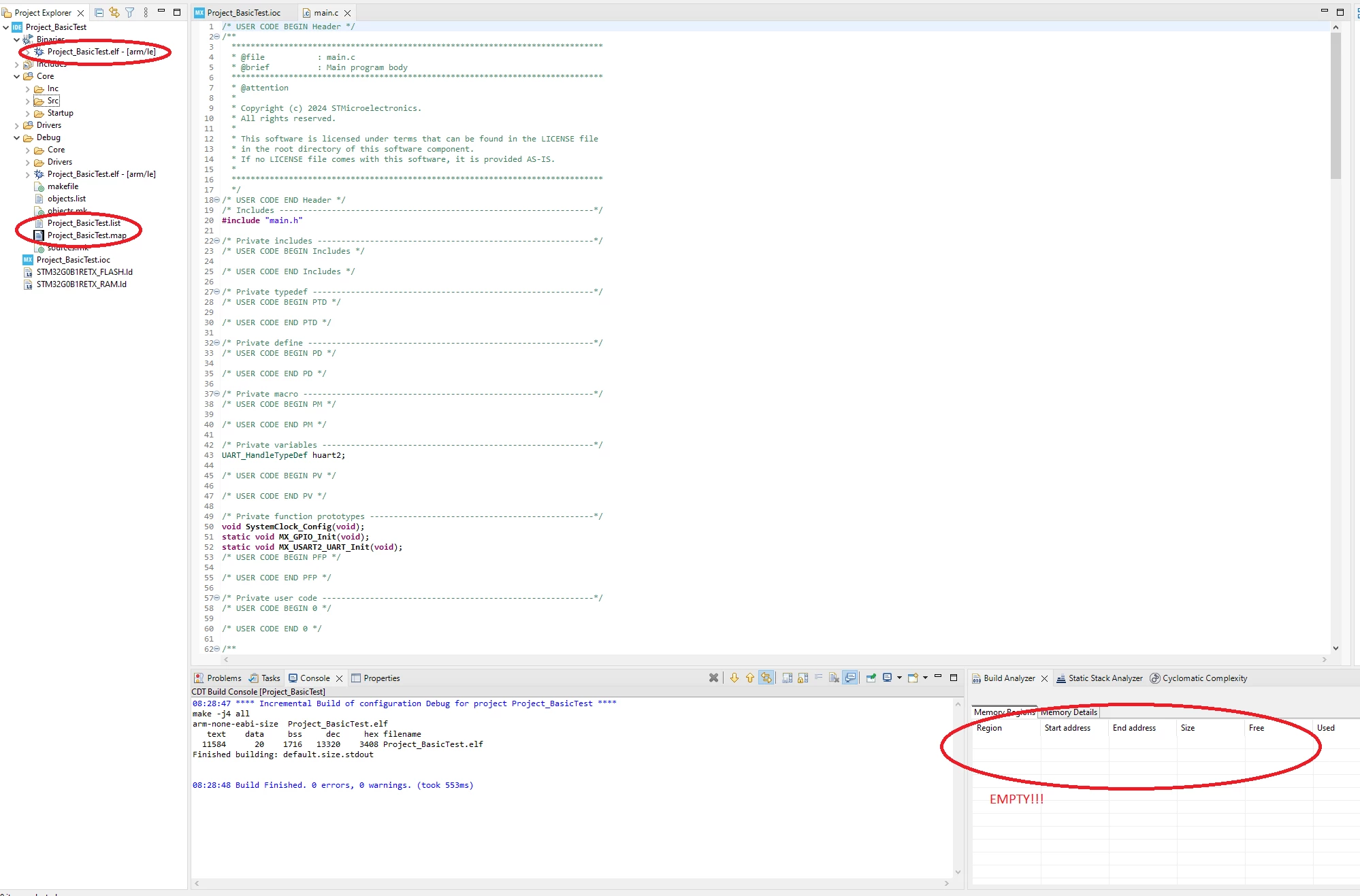

    The Memory Regions tab is empty if the elf file has no corresponding map file.
    When a map file is found, the region names, start address, end address, total size of region, free size, used size and usage information are presented.
    So, make sure that the correct elf file and project are selected.
    For that, I recommend following the chapter "2.4 Build Analyzer" of the STM32CubeIDE User Guide:
    "The STM32CubeIDE Build Analyzer feature interprets program information from the elf file in detail and presents the information in a view. If a map file, with similar name, is found in the same folder as the elf file the information from the map file is also used and even more information can be presented."

    I've just compiled the default NUCLEO-G0B1 project example, and I think there's already a .lst and a .map file:

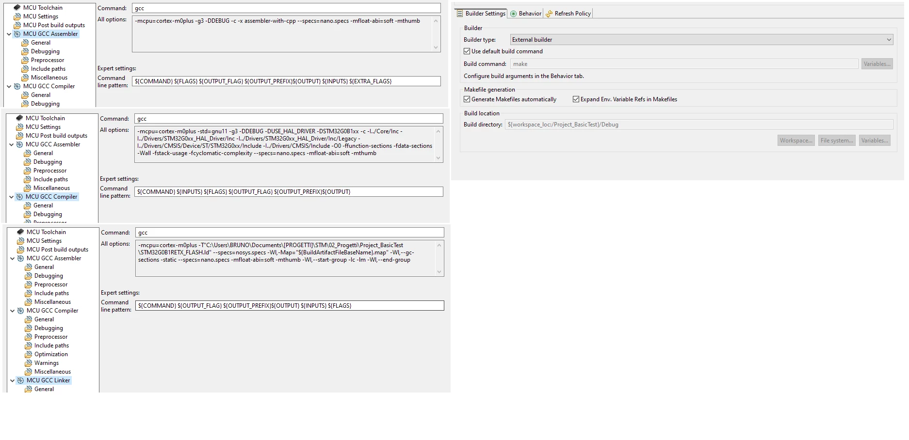

    And here's my settings (they could be all default values):
    Is there something missing?

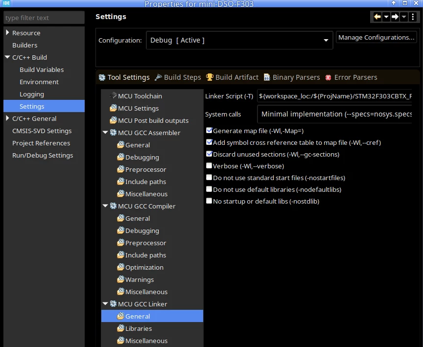

    By the way, my options are
    and I think the .map file is already generated with the linker options. Do you think there's something wrong?
