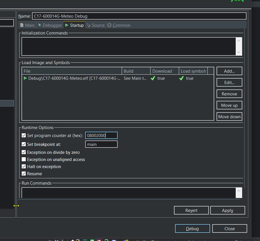

I have reserved 8K of flash in my STM32F030CC for a bootloader/updater program so my main application starts at 0x08002000. When I compile and debugg, the debugger is smart enough to know where to start, but when I click on reset session and start debug the chip seems to be reset and I guess it tries to start at 0x08000000. Is there anyway to tell the debugger to start where my application code starts after a reset?
I have tried the option "Set PC at 0x08002000" which is where the flash for the app image starts, as seen in the picture but there is no breakpoint at start from where to start.
have also modified the script for the linker as follows.

Pavel A.
July 18, 2020
An usual advice is to always have some kind of bootloader in place so it will jump to your app.
If bootloader is not ready yet, put there dummy minimal code for now.
-- pa

Hi Pavel,
As you very well suggested I put in place a light version of booloader in memory and in fact now when the chip resets, I guess it runs my bootloader code and jumps into my application.
Now I am able to restart the debugger session without having to flahs the micro every time. Thanks for that!!
Nevertheless I thought the debugger was smart enough to be able to be configured to start from a custom memory address...
Thanks a lot again!
