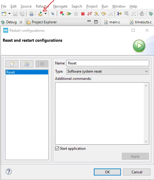

The debug reset button is supposed to reset the MCU to project start it which is main()
In my project, it was working fine until for no clear reason it stopped and now it throughs me to some random address.
I'm using STM32CubeIDE
Version: 1.12.1
Build: 16088_20230420_1057 (UTC)
STLink and STM32F407
Any idea on how to fix this issue ?
thx
Should work. What address? Sounds like it's doing something. Perhaps a bootloader is being run instead.
Try on a different board/project.

Thank you for your feedbakc,
I created a new project using CubeMX and it is working fine but in my main project it doesn't work.
No bootlaoder involved here.
How would I investigate this issue further ?

Can be related to low-power modes. Try setting the debugger to a hardware reset type.

Thank you all for your feedback.
Issue found. The bootloader was missing after full erase of the chip
