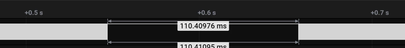

November 4, 2021
> You could toggle a pin in a tight loop and verify.
I did this. On an F429, setting a hardware breakpoint while the program is running halts the CPU for 110ms. Certainly explains the issue. Likely setting DBG_WWDG_STOP would prevent the WWDG from resetting here.

Whoa! Thanks. I wouldn't have guessed it's that much.
