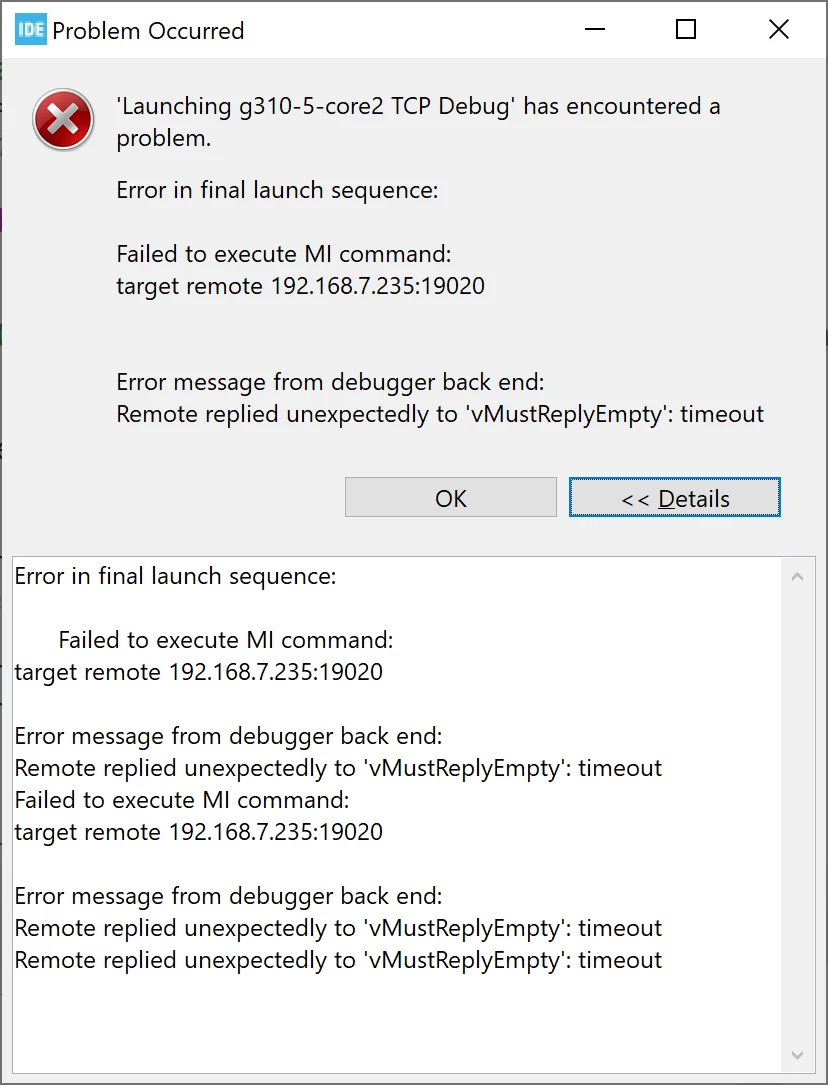

I am having issue debugging/ programming via STM32 Cube IDE with the J-Link probe (USB) connected to a remote host (TCP connection).
Whenever I am trying to debug/ program, the STM32 Cube IDE hangs for a while and eventually shows an error:
_legacyfs_online_stmicro_images_0693W00000bizCEQAY.pngI am not experiencing this problem when connecting remotely with JLink CLI directly.

During the connection attempt via STM32 IDE I can see in the GDB server CLI that a client is connected.
Waiting for client connections...
Conn. 8: Client connected.

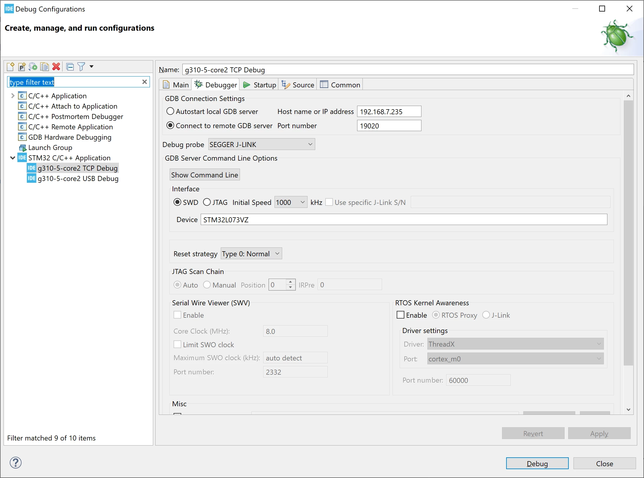

My debug config is:
_legacyfs_online_stmicro_images_0693W00000bizCOQAY.pngDid anyone else experience a similar issue? I would appreciate all help!
