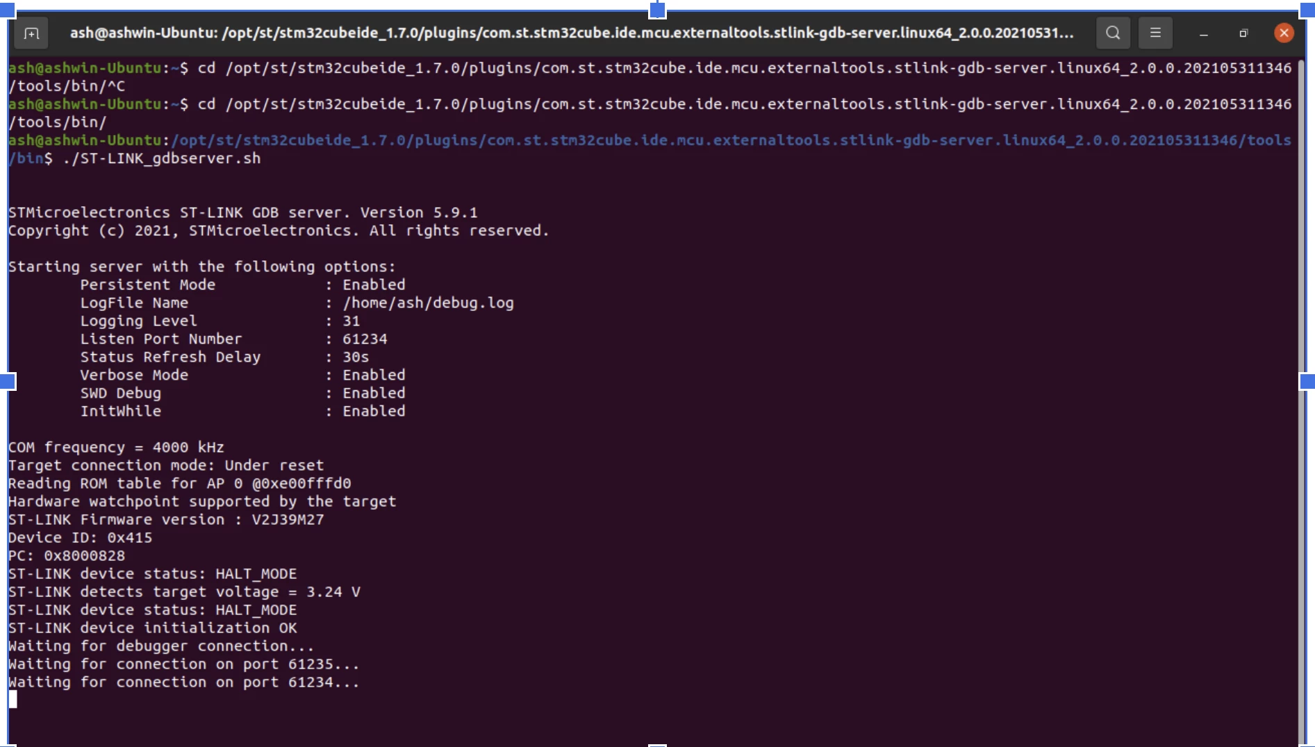

I have connected the nucleo board to a linux machine (Ubuntu) and have started the ST-LINK_gdbserver application from /opt/st/stm32cubeide_1.7.0/plugins/com.st.stm32cube.ide.mcu.externaltools.stlink-gdb-server.linux64_2.0.0.202105311346/tools/bin/
After I run the application the terminal window shows the following information.

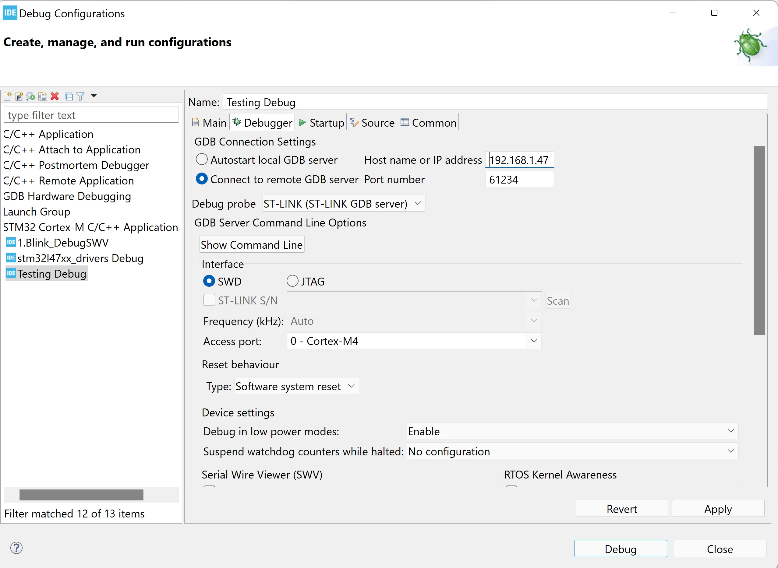

0693W00000JP0oWQAT.pngThe stm32Cube IDE is running on the local pc(windows) which is connected to the network. The debug configurations is configured as follows

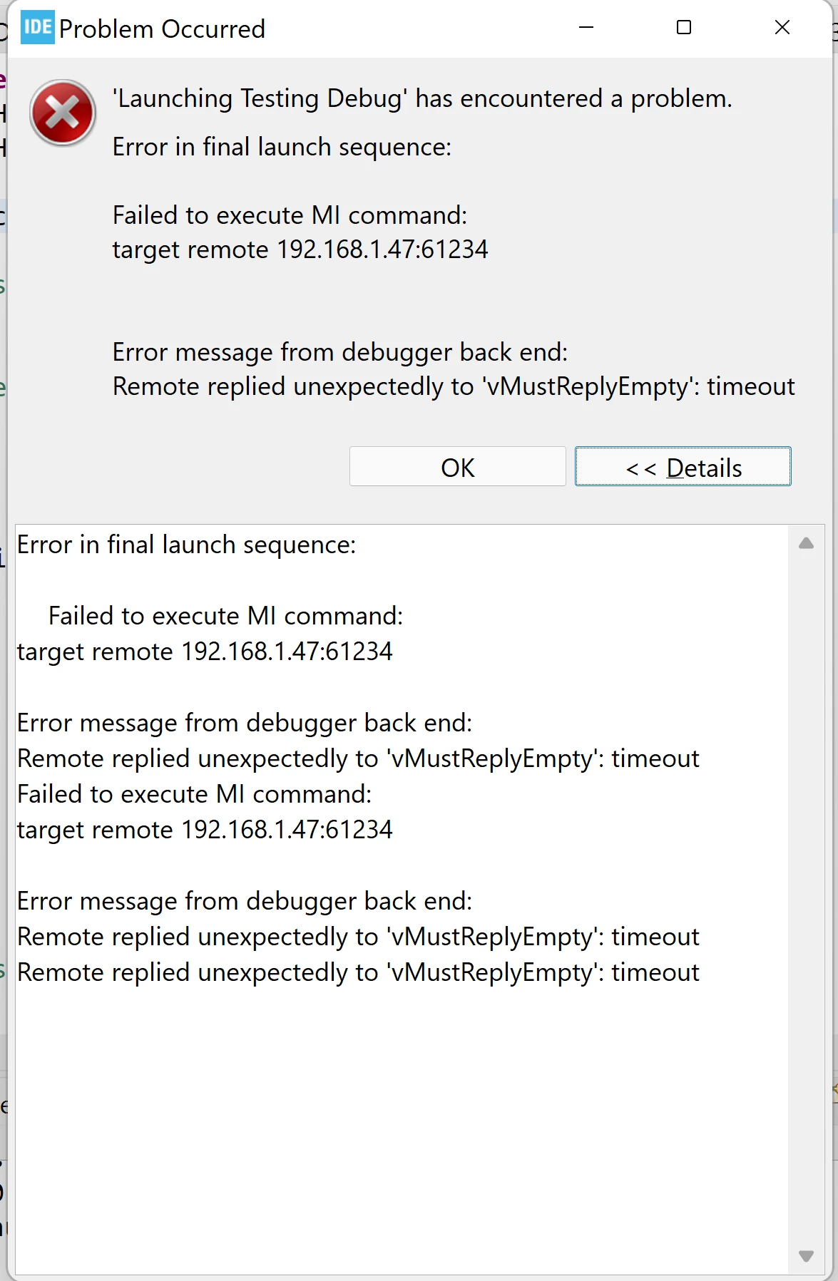

0693W00000JP0m8QAD.pngWhen I try to debug the application the following screens appear
Can you help me to solve this issue or can you provide me with a solution for remotely debuging the application from another PC on the local network?

Can you test the following:
  • Create a new debug configuration from scratch on the windows machine.
  • Change it to connect remotely.
  • Run it.
This is just to rule out any portability issues in case the debug settings moved between different platforms.

The connection seem to work well which contradicts the initial error dialog you received with Failed to execute MI command: target remote...
Can we do a screen share session? Drop me a PM and we can have a look...

Just an idea. Might be related to network latency. Test to increase the "Remote timeout" setting. Available under:
"Window->Preferences->C/C++->Debug->GDB"
Default GDB timeout is 2s. Test to set it to 10s.

We have now managed to reproduce this error message in cases when the network communication (server responses) is really slow.
In addition to the reply by @Community member​, you could also try to increase the debugger maximum connection time limit. Currently there is no UI option for this but a workaround is to add the attached two file to the project root folder. This will increase this time limit from 15s to 30s.
This might solve the problem but the interesting question is why its so slow in the first place?
