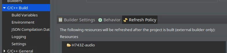

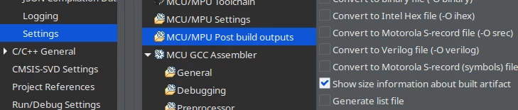

settings in IDE - > project →
maybe you have to click on other project and then again to actual project, to get screen updated

i checked those 2 settings that you mentioned and both of them was looked like pics.
I realized something new : when close build analyzer , clean-build project , switch refresh option from build view setting between auto and on request and applied.
build analyzer accept my refresh .
