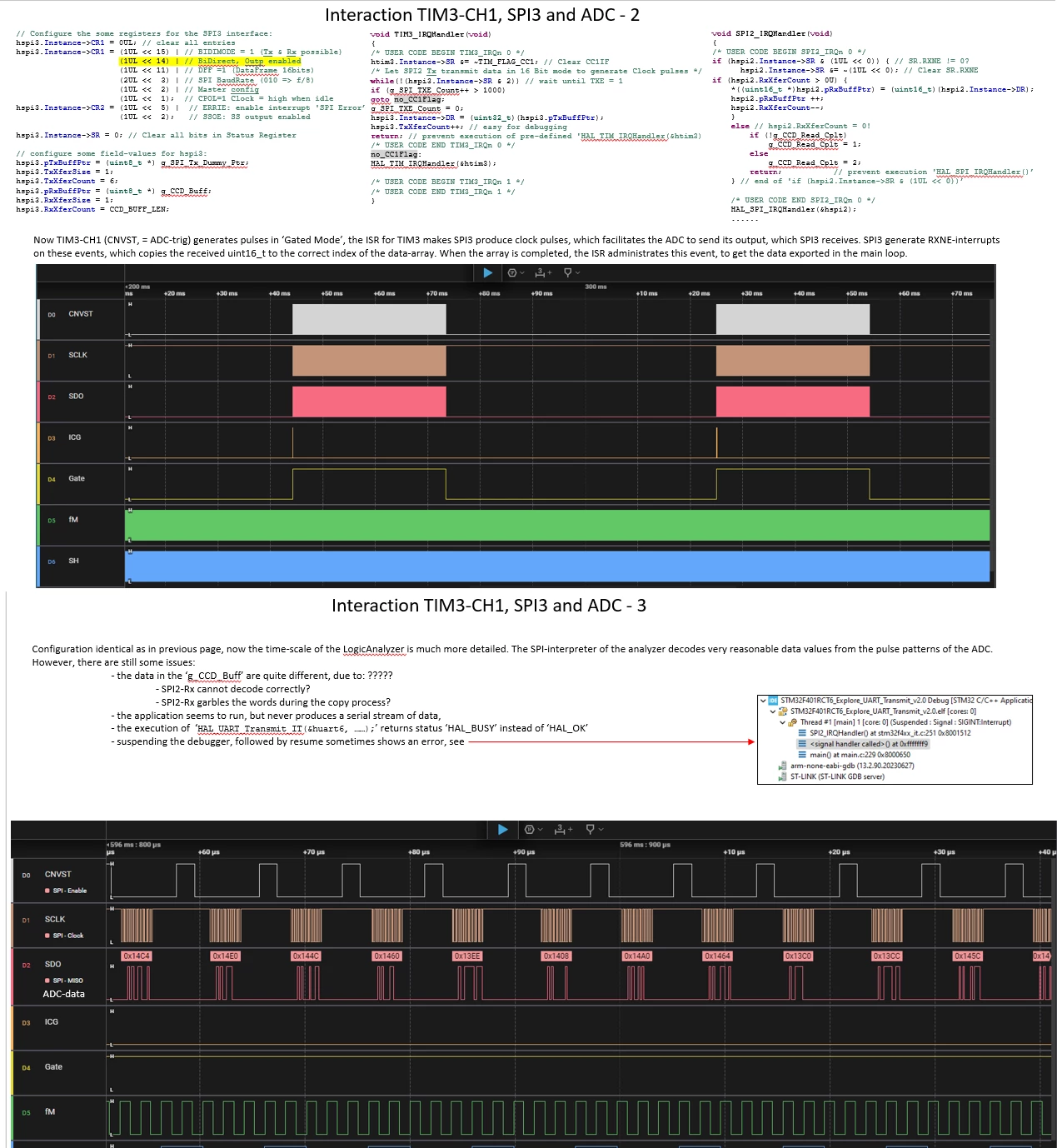

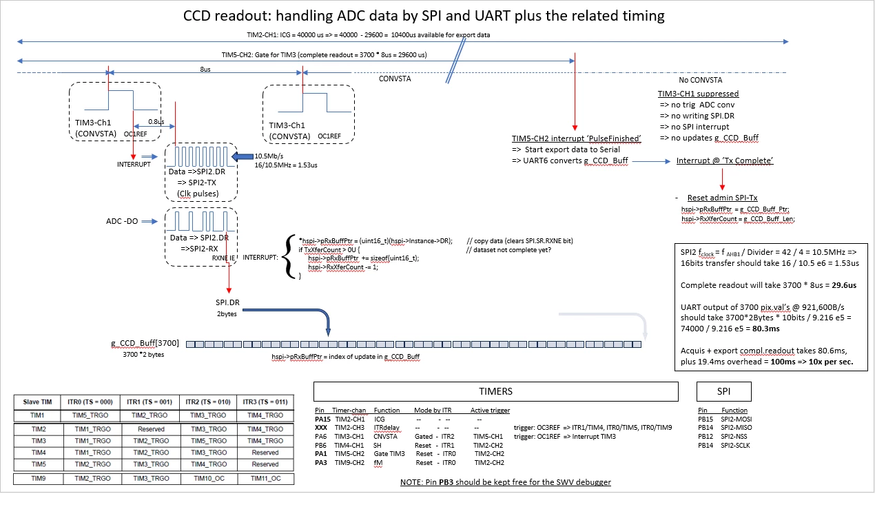

The project aims to readout light-intensities from a TCD1304 linear CCD with 3694 pixels, in order to measure mechanical displacement with high precision. I apply a 16bit SPI ADC (ADS8319IBDGST) for the analog intensity signal. Once all data is collected, the values must be exported as serial stream. I decided to split the functionality of the application in two phases that won't disturb each other, by means of gating the ADC-trigger. When suppressed, it will not activate the SPI (no updates on the data-array), while the UART outputs the stream. This requires a fifth Timer, also synchronous with the the other ones.

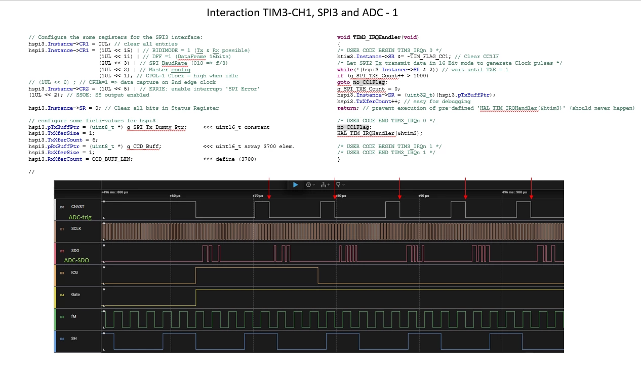

The strategy is: TIM3 (the ADC-trigger) starts the ADC-conversion by its rising edge; it also is configured to fire an interrupt at its falling edge. The related ISR is adapted: it writes a constant uint16_t to SPI-DR. This SPI is configured as Full-Duplex Master, HW NSS, 16bit, 10.5MHz clock and to generate interrupt when RXNE=1. Writing to DR causes the SPI to generate Clock-pulses, which allow the ADC to output its result word to SPI-MOSI. After SPI has received the ADC-word, the RXNE interrupt is fired. The related ISR is also adapted: the DR is copied to SPI.pRxBuffPtr (@ the correct index of the data-array) + the pRxBuffPtr and RxXferCount are updated (Register programmed). This mechanism should handle the time critical part of the code with a limited #instructions, so execution within 8us should be possible for a 84MHz CPU (??) This strategy is my interpretation of the replies by this forum on an earlier request for help.
The SPI ISR checks the RxXferCount to be positive; when 0 is reached, a flag is set to output the data by UART6. At the same moment the gate-pulse will end, stopping the ADC and the SPI, leaving the data-array untouched. The output-flag is polled in the main while-loop, the conversion is non-blocking (HAL_UART_Transmit_DMA(&huart6, ...)).
The debugger shows strange behavior, like running without ever reaching the breakpoint on the main() while-loop'. Does this mean all CPU cycles are consumed by the ISR's?
By close observation of the SPI-SR bits, I found the SPI changed from Master to Slave, directly after enabling. Reading RM0368 again learned me I configured the SPI incorrect: MSTR=1, BIDIMODE=1, BIDIOE=1 and SSOE=1. I had empirically found this combination being required to let the SPI produce 16 Clock-pulses after each ADC-trigger, only during the 'gate' period. However,this combination puts the SPI in 'Tx only' + 'Master-Mode Fault state'. I realized I need a SPI, configured as 'Slave RX-Only', meaning I have to supply the Clock-pulses myself. The only way-out I found was to apply a second SPI as 'Master Tx Only', trigger it as described and use its Clock pulses for the Slave SPI.
I implemented this new approach with some success: the signals on my LogicAnalyzer look OK, just as the values of the SPI-decoding (see attachment 3). However, a closer look at these values learned there are series of ADC-values shifted one bit, equals one clock-pulse.
This is not acceptable and screws up my whole design, at least I fear that.
